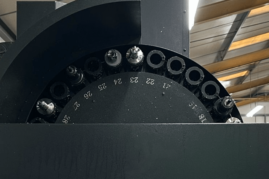

But then one day you want an M6 tap and you see one in the tool drum.
How do you get it?
It’s number 20 in the tool drum and only the machine knows what that is.

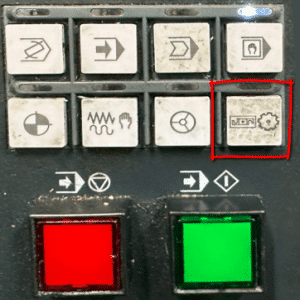

So to acces the tool table on a Doosan machine we first press this button.
Doosan Access Tool Table

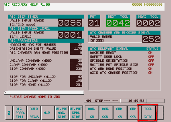

You will then see this screen.
Random Tool

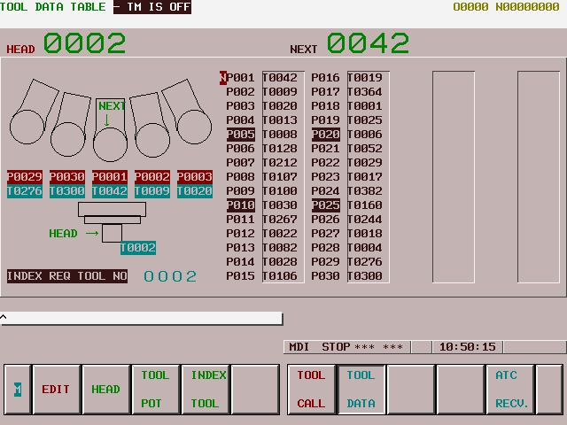

Press TOOL DATA

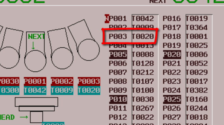

So here we have it P is the pot number (the position in the drum) and T is your tool number.
So if you wanted the tool that is in pot number 3 in the tool drum you would type M6 T20.
