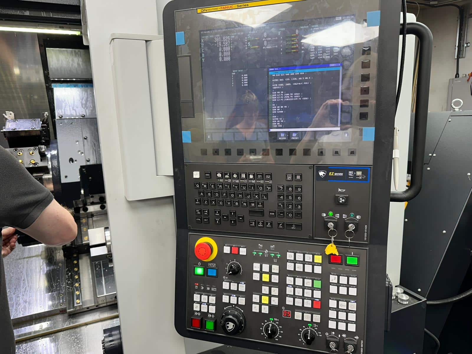

The Control
Now I’m going to moan and praise in equal measures. This machine has at least three ways of doing everything. Now this is great for people like me who love playing with gadgets and never done an honest days work in their life.
But for a total beginner it’s a shit storm. I’m never sure which way to show them. You have what I call traditional Fanuc. Then you have Guide i. Then you have EZ Guide.
I love em all and I can give you great things about them but for training you risk confusing the living shit out of your trainees. What do you show them?

So the first one I might stick with the traditional Fanuc and show them how much better the Graphics and the editing are in Manual Guide. Maybe show them a few things like the M and G code lists in EZ.
Doosan Lynx 2100 LSY
Second one I think just stick with Guide i and hope they don’t notice the other screens and ask too many questions.
Third one new comer I’d show them EZ but then have to add a bit of Guide i
One of the guys I trained this week was already competent with Guide i and basic Fanuc. This meant he could take in a lot of the extra stuff without being totally confused.
Don’t get me wrong I love the control cos it kind of gives a versatility to it but fuckin hell give me a break I train folks for a living.

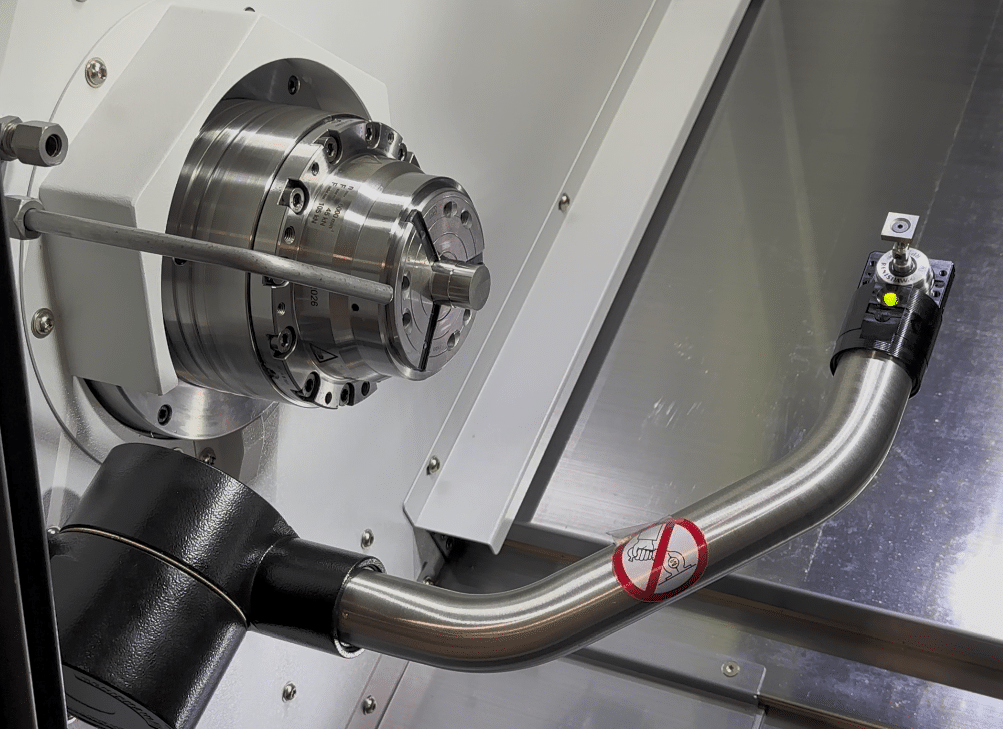

Tool Measurement Arm Doosan Lynx 2100 LSY
As you might already know with a sub spindle machine each station can have two offsets one for the left spindle and one for the right. T0101 left. T0126 right.
This means left side uses offset one and right uses offset 26.
Machines I have worked on you have to set tool 26 on your pre-setter write it down and enter it by hand. That’s because the tool arm jumps to the offset corresponding to the turret position.
Pain in the arse.
Now I haven’t seen this on a machine before. I know that by parameter you can stop the machine from jumping to the offset.
On this Doosan Lynx 2100 LSY you can set the machine to jump to said offset but then at the press of two buttons it will allow you to move to another offset.
Genius I think this is great. Just let me know if it’s me or is this something great on a Doosan machine? Anyway I fuckin love it.
