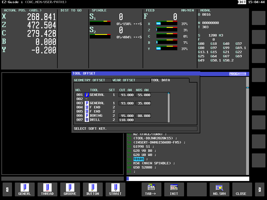

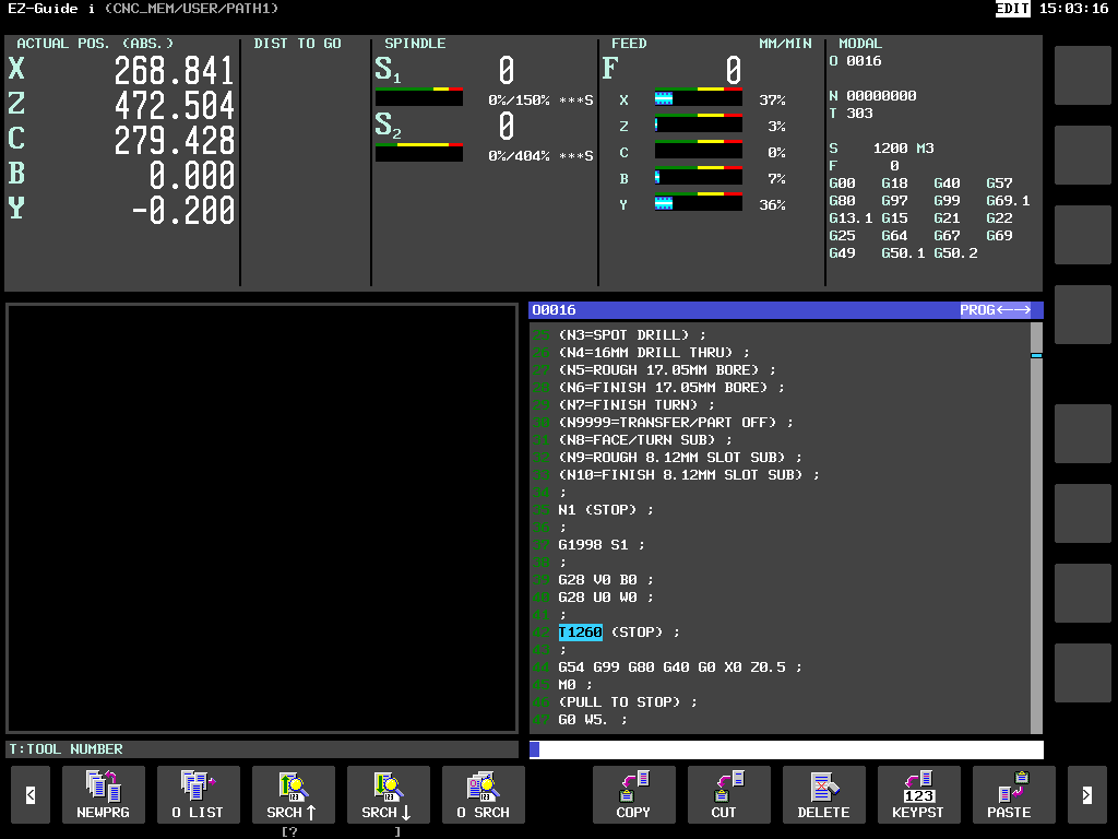

You can click on a tool like in this picture T1260 then press INPUT
I Love Guide i
And it will jump to the tool file.
I Love Guide i

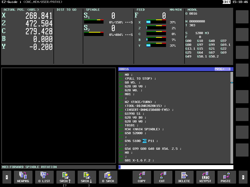

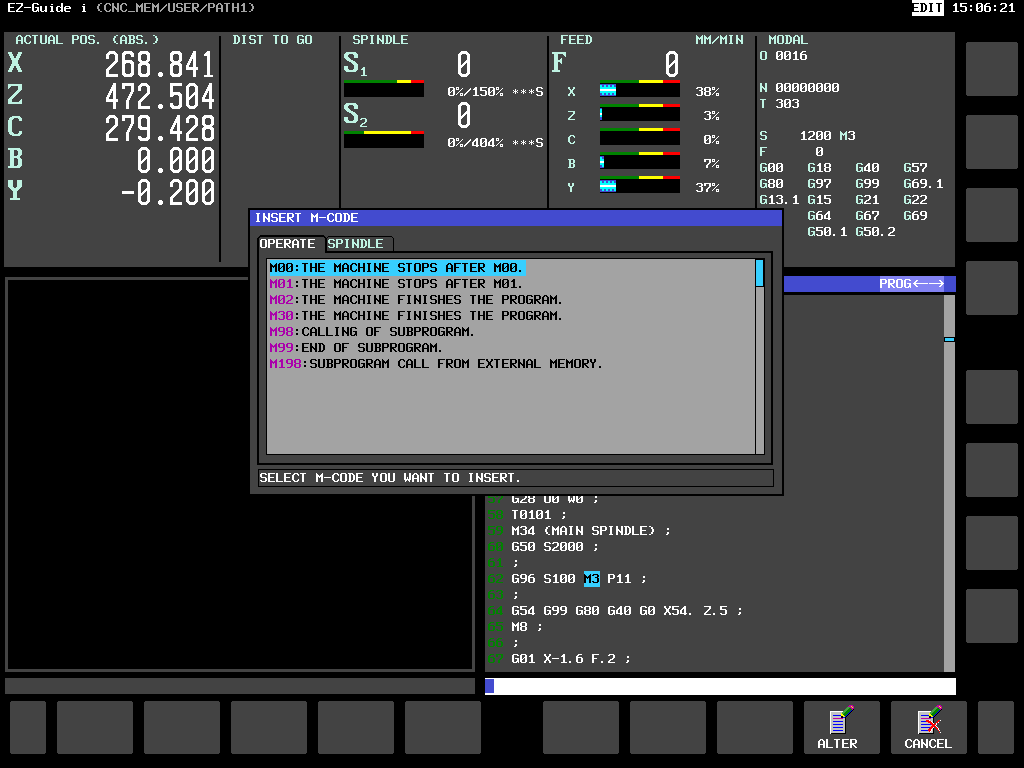

Now try clicking on an M code and press INPUT.
I Love Guide i
Wow an M code list comes up. I recon that’s impressive and very useful to boot.
I Love Guide i

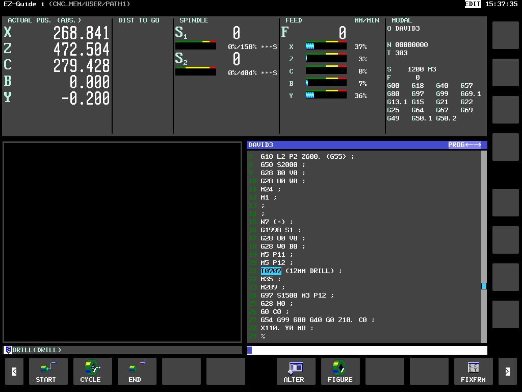

I you have it and you don’t use it then you bloody well should. another reason is that when you click on a G code or M code down the bottom left it tell you what it is. Don’t you just love it. Oh and one more thing if you can be arsed to put all your tool descriptions in it will tell you what they are too.I Love Guide i
