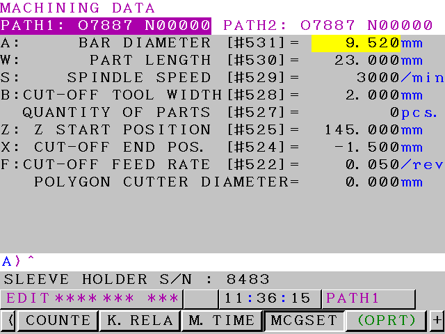

Star SB-20R Set Parts Counter

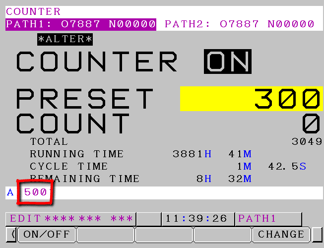

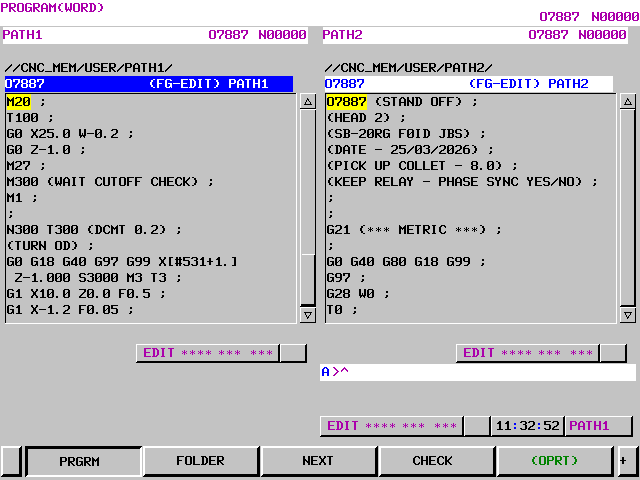

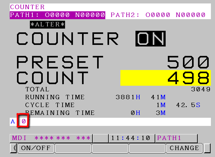

This machine is a sliding head CNC Lathe it runs two simultaneous programs. This article shows you how to set the parts counter screen to your required number of parts.
It also shows how to reset back to zero after your parts have been completed.
The machine is a Star SB-20R sliding head.
In your program an M20 tells the counter to add one part to its counter, there it is in yellow on the left hand screen.
Now press your CSTM GRPH key
This is the page you want to see.
Star SB-20R Parts Counter
You may need to press the green OPRT button below to find the screen.

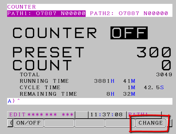

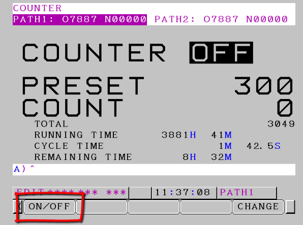

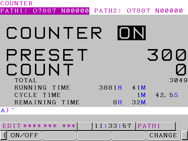

Press COUNTE and you’ll get to this.
Press the ON/OFF key to switch counter on and off.
