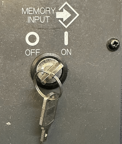

You will need your keyswitch in the on position to allow any kind of editing
In the off position below you will not be allowed to edit

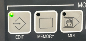

First of all you need to be in the EDIT mode.

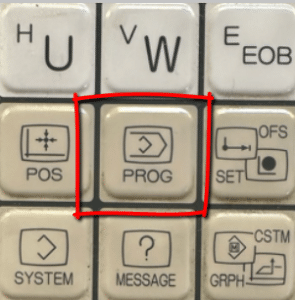

Press PROG to view your program.

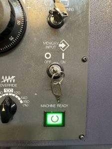

You will need your key-switch in the on position to allow any kind of editing

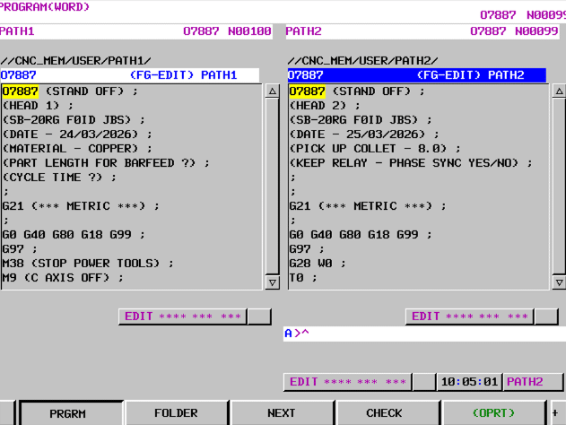

Because this machine is a sliding head machine running two simultaneous channels you have to select a path.
On standard machine you will not need to do this.

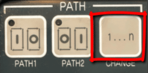

First of all turn off the path buttons.
Now select which Path you want, just press below.
The PATH change button will select which path you want. Whichever path you are in the program number will highlight in blue. It will also show in the right hand corner.
