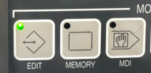

First of all you need to be in the edit mode.

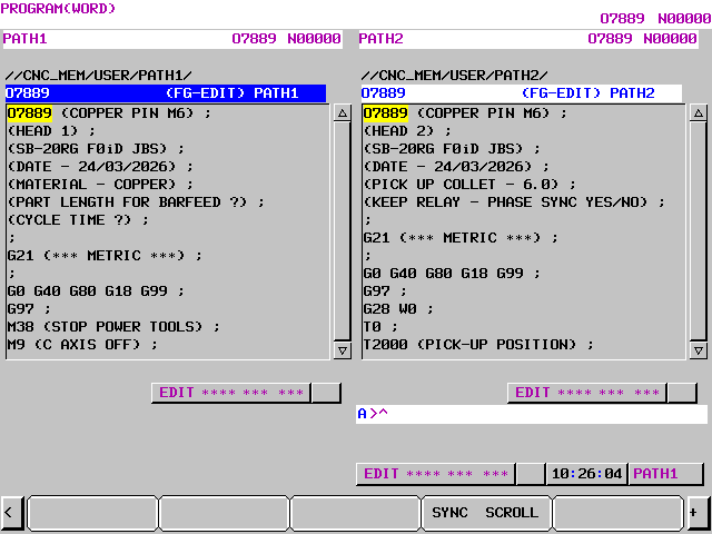

Cursor across until you see SYNC SCROLL
Now press it

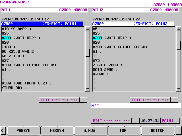

The SINGLESCROLL button will take you back. Now as you cursor through both programs will scroll together. When you find a wait code it will turn blue. The opposite screen will keep scrolling till it finds the corresponding wait code.

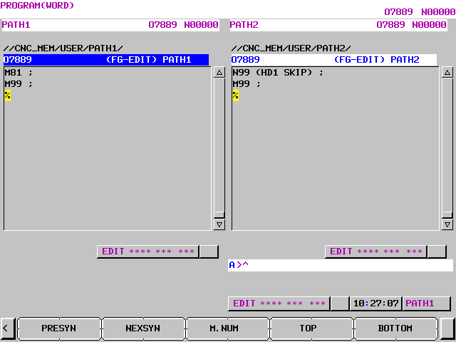

BOTTOM will take you to the end

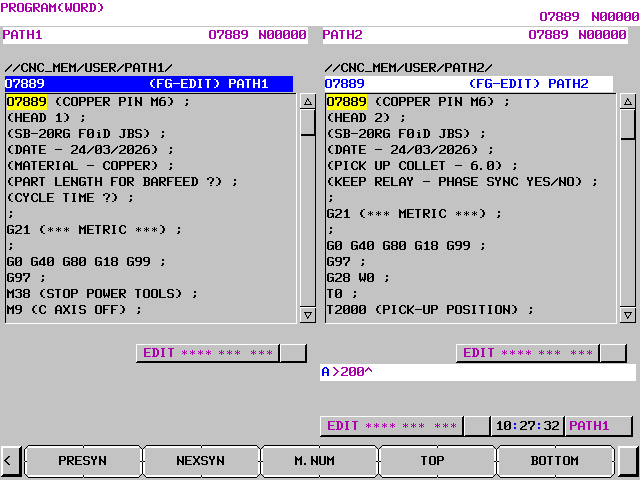

If you type in a wait code number for example 200
When you press M.NUM it will find it. Use the NEXSYN to jump to next wait code and use PRESYN to get to previous sync code.
