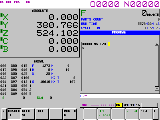

If I wanted to use pocket three then call it in MDI tool 20 (M6 T20).
Doosan Tool Drum
Now you can load your tool, if the pocket is empty, or exchange it with this tool.

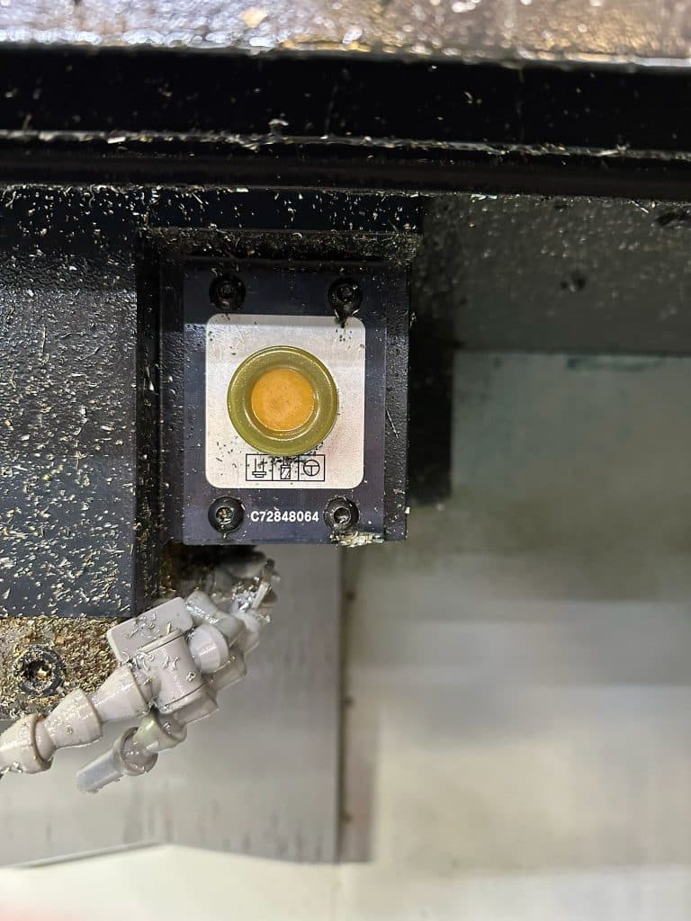

This button will release the tool if you are in a manual mode.
The tool can be heavy or stick in the spindle so be prepared for it to drop. It may be heavy so you could put a piece of wood under it to support i

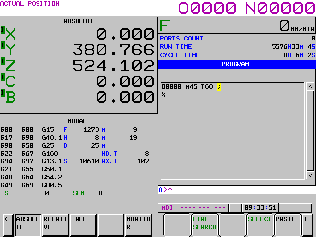

M45 will effectively change the tool number in that pocket M54 T203 means your tool will from now on be known as T203.
M6 T203 will get your tool. Don’t forget it’s now using offset 203.
This applies to you H and your D offsets.

Now in MDI input M45 T60.
