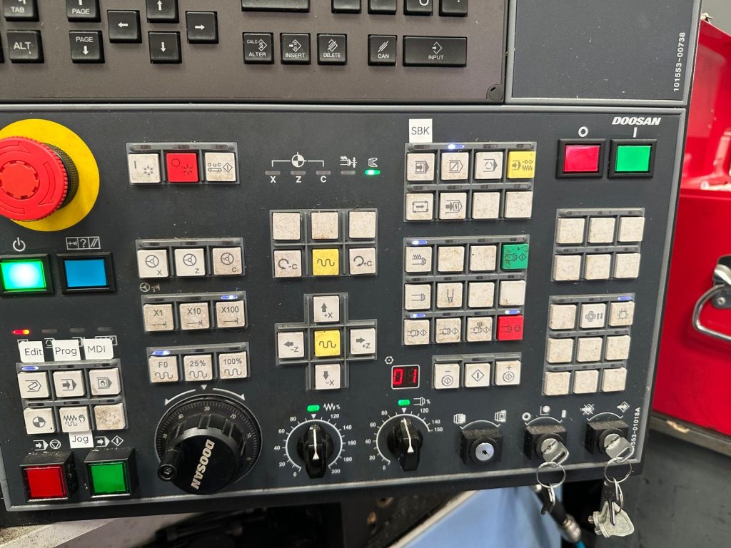

Doosan Lynx 300M G130
On a Doosan Lynx 300M, G130 can be used to set the machine’s G30 second reference position.
The interesting part is that G130 is not doing the work itself.
Read on if you are scared of fucking with parameters.
On this machine:
G130
calls:
O9019
This is done using Fanuc parameter 6059.
If parameter 6059 contains:
130
then G130 calls macro O9019.
