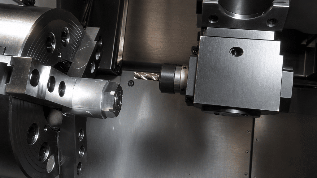

Engraving on the Front Face
Face engraving on a CNC lathe is normally completed with an axial driven tool.
How an Axial tool looks
The tool points towards the front face of the component, parallel to the machine’s Z axis.
The engraving movement is produced by coordinating the machines X axes with the C axis.

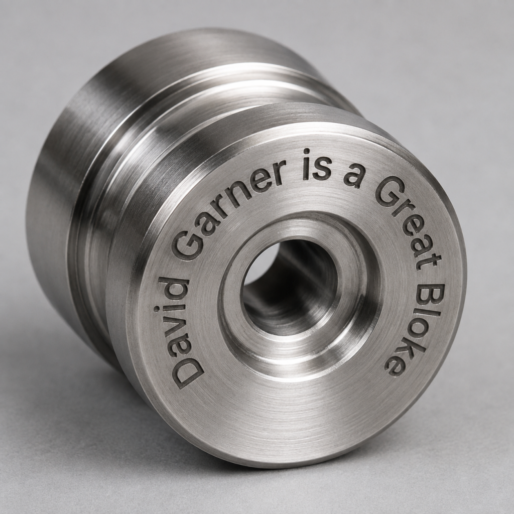

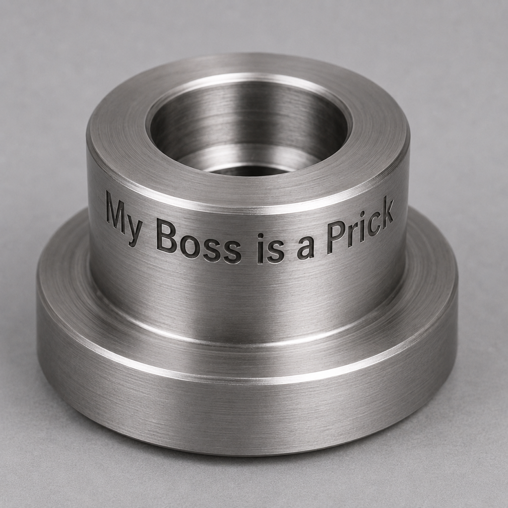

Engraving Around a Diameter
Engraving around a diameter is where having a C axis becomes particularly useful.
For this operation, we normally use a radial driven-tool holder. The engraving cutter points towards the centreline of the component and cuts into its outside diameter.
FANUC Manual Guide i engraving
The Z axis controls the position along the length of the component while the C axis rotates the component.
This allows the text to wrap around the diameter.
You could engrave a part number around a collar, add a company name to a component or mark a round part without removing it from the machine.
The control must convert the linear length of the text into rotary C-axis movement.
The component diameter is important an error in the diameter entered can alter the size and spacing of the completed text.

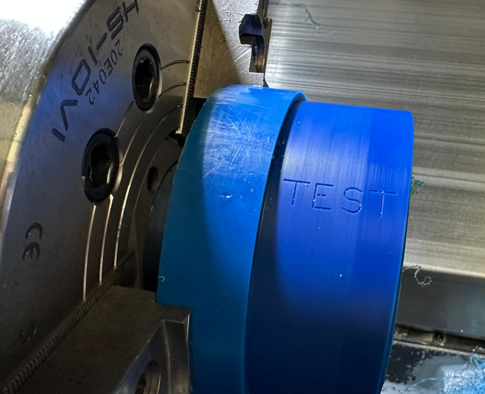

It is a good idea to prove the Manual Guide i engraving operation on a test component or a scrap piece of material.
Add some to the offset to begin with the tool slightly clear and adjust the offset gradually until the engraving looks correct.

Prove the Operation on the Machine:
  • Single Block
  • Lowest rapid override
  • Start with low feed override
  • A safe starting position
  • You can move datum and machine in fresh air to test.
  • Be particularly careful when using a radial driven tool close to the chuck.
  • The cutting tool may have plenty of clearance, but the body of the driven-tool holder or turret may not.
  • The chuck is unlikely to move out of the way simply because you have made a mistake.
  • You may need to reset the C Axis datum so that you miss the jaws of the chuck.

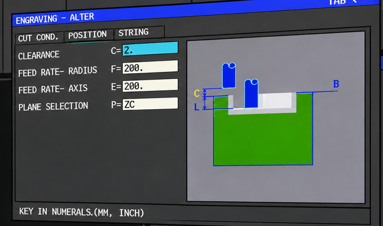

    First of all on your cutting conditions tab give clearance above your part (C)

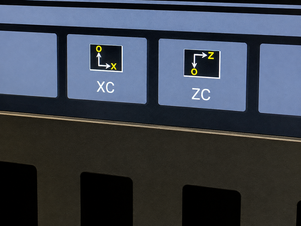

    Give it your feed rates and then the PLANE SELECTION.
    This will give you two choices. It might be helpful to think of C as your Y axis.
    This would be the front face (XC)
    This would be wrapped around the diameter of your part.
    ZC Result
    This is what ZC would give u
    s

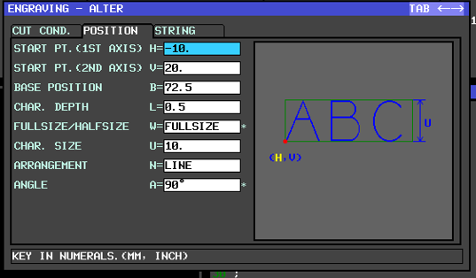

    Position Tab
    Hit the POSITION tab
    H-10. means I am 10mm away from the front face of the part.
    V20. is the angle, normally this can be zero but it is where the text is placed around the diameter.
    The base position would be the radius that I am placing the text on. B72.5 would mean I am on a 145mm diameter. Were you to place text on the front face then you would chose XC and this B figure would be zero
    You have a choice of full or half size characters.
    The CHAR SIZE id the height of your lettering

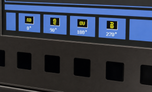

    ANGLE is the angle that the test is at chose the icon

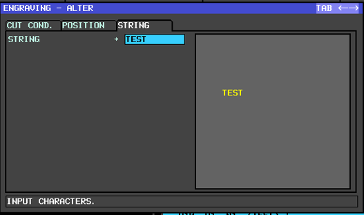

    Click the STRING tab and type in exactly what you want to say
    The Actual Text
