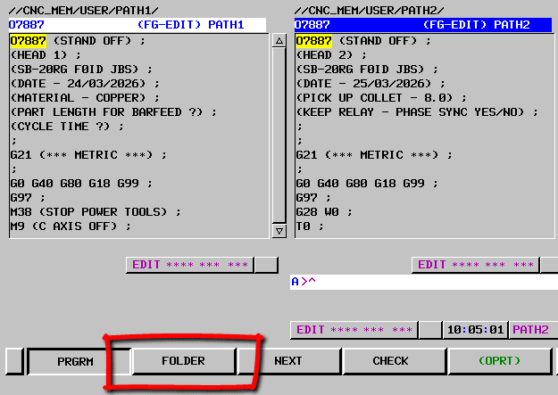

Star SB-20R Set Parts Counter
This machine is a sliding head CNC Lathe it runs two simultaneous programs. This article shows you how to set the parts counter screen to your required number of parts.
It also shows how to reset back to zero after your parts have been completed.
The machine is a Star SB-20R sliding head.
In your program an M20 tells the counter to add one part to its counter, there it is in yellow on the left hand screen.
