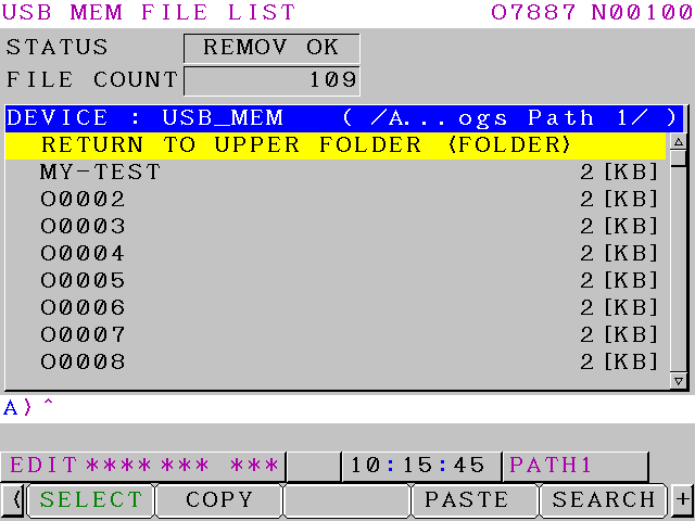

You now need to change devices to the USB, cursor across until you see the green DEVICE button.
Select USB MEM and your USB menu will be shown.
Star SB-20R Save Programs
Pressing the PASTE key will paste your programs onto your USB stick.
Move right up the list to the yellow line.
When you press INPUT you will move back through your folders should you want to place the programs in a specific folder.
