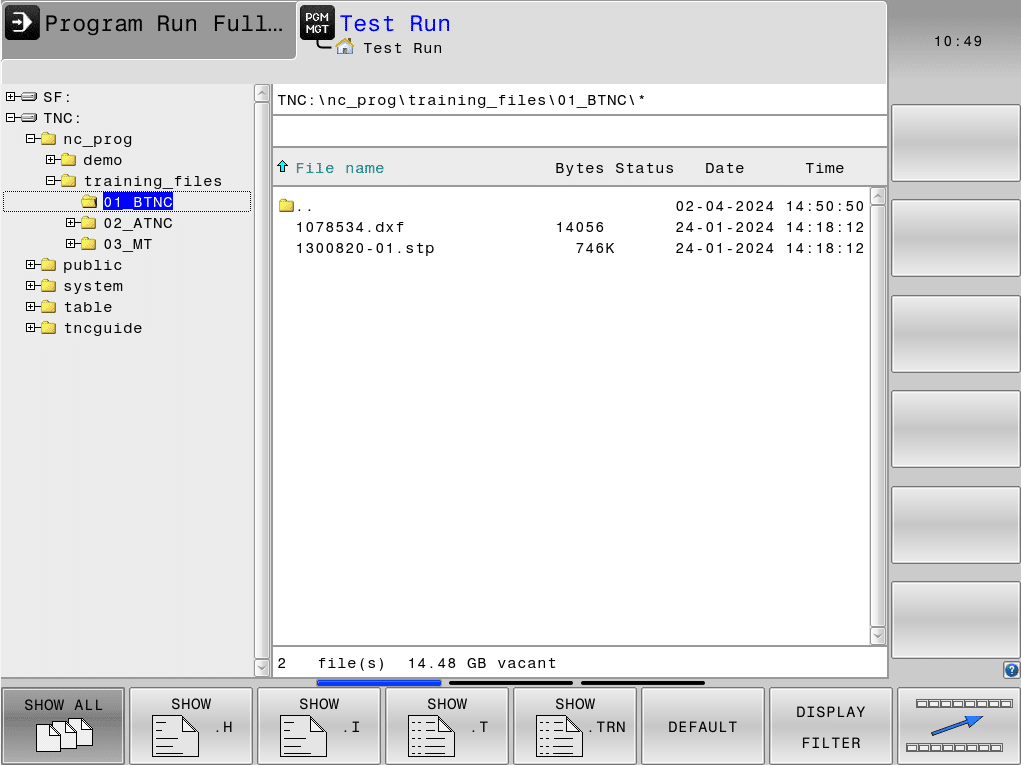

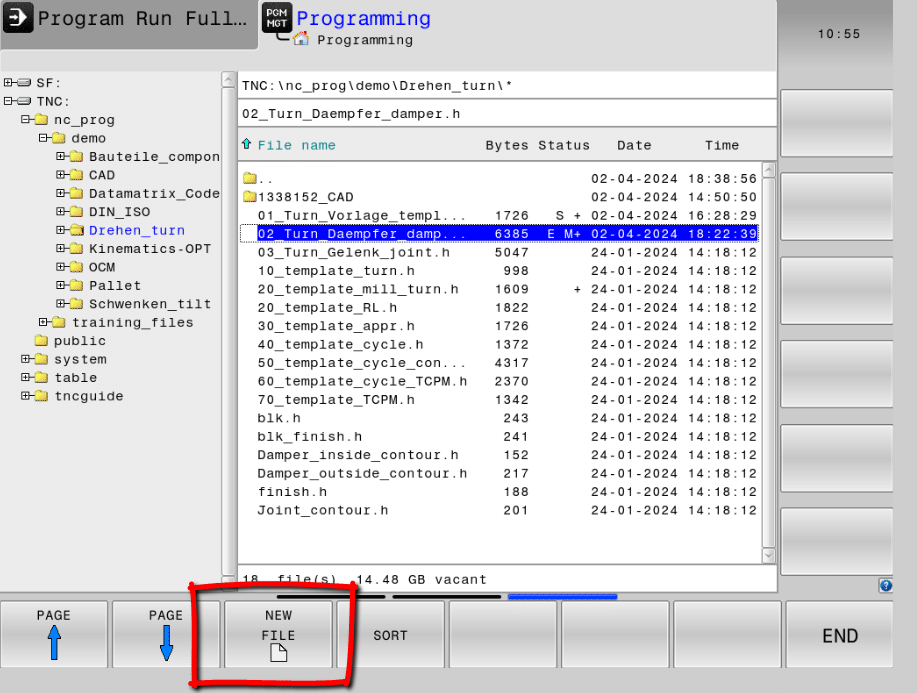

When you switch from Edit to Program Run or Test Run you need to select the program you want. Unlike Fanuc when you switch from edit to program your program is not automatically selected.

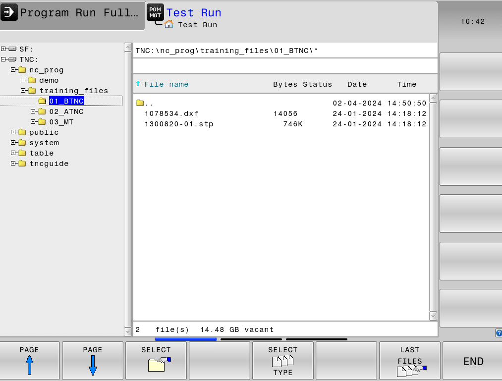

This button to the rescue select your mode for example Test Run then press PGM MGT
You will see this screen
There are two buttons here that on a personal level get me in an absolute frenzy.
SELECT TYPE and LAST FILES
Press SELECT TYPE first.
From here you can select the file type you want to display best to chose .H which means you will only see the Heidenhain files. It also means that when you create a file by pressing NEW FILE (in the edit mode) you get Heidenhain by default not ISO G code.
Any program you create will automatically have the dot H extension meaning it will be a Heidenhain file.
Just write it in and the dot H will be added.
It also makes it a lot less complicated when looking for program as you won’t see all the other stuff.

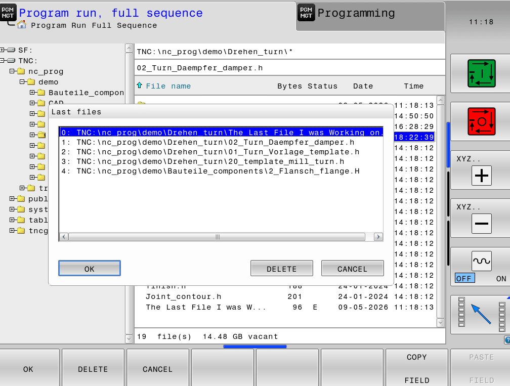

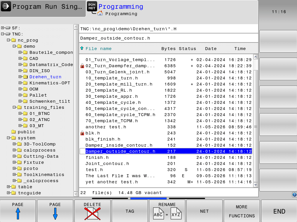

Heidenhain Quick Acess to Last File
Now onto the next little beauty LAST FILES
Go on give him a nudge, he’s your best friend.
What this does is give a list of all the recently used files, so yours will most likely be at the top or at worst very near.
If you are using a lot of directories and shit. This will make it very simple and you wont have to trawl through loads of folders to find what you were working on.
Therefore when you switch modes you can instantly get the last file you were working on.
All you need do is press OK.

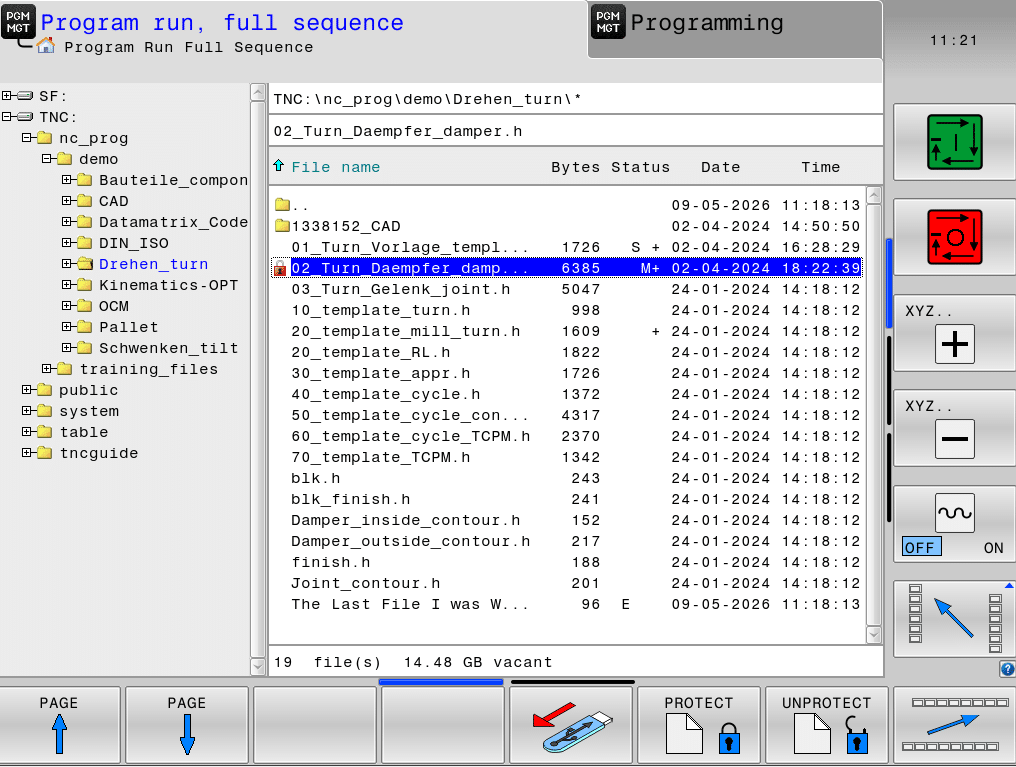

Heidenhain Are You Unprotected?

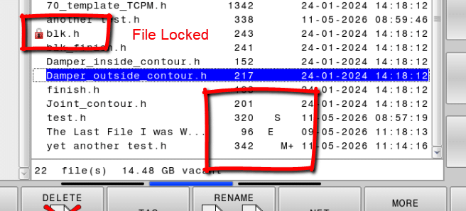

Oh yea another thing, cursor across and you’ll see PROTECT and UNPROTECT.
This puts a little padlock next to your program. This stops any naughty apprentices from deleting your programs, unless of course he really wants to.

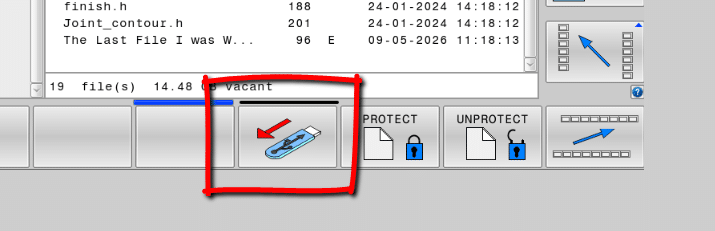

Don’t just Whip Out Your Stick
Now if you are an upstanding honest citizen you will know that you should never just whip out your stick. Especially in a crowded bar.
Always safely disconnect your memory stick not just yank it out like some decaying tooth. You might need to press the MORE FUNCTIONS button first.
You’ll love this button if you like to do things properly.
Just press it, you never know it might save you from wiping a memory stick clean.

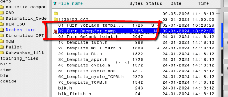

But here is an example if you look in the directory it will tell you the program active in Edit, Full Run and Test modes with the letters M E and S. How cool is that?
M (Memory)
E (Edit)
S (Test Run)
Padlock (File Locked)

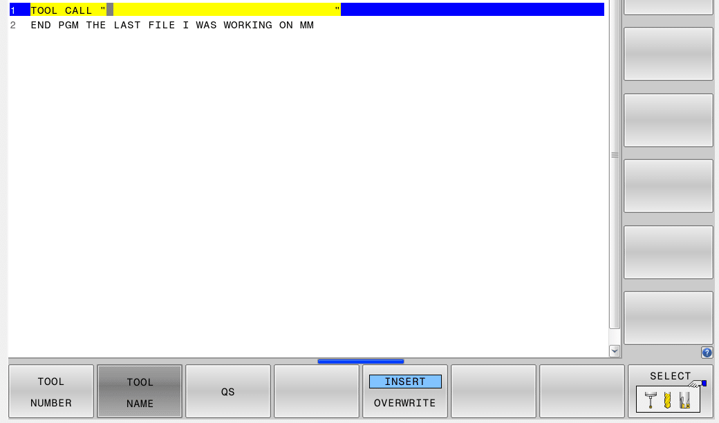

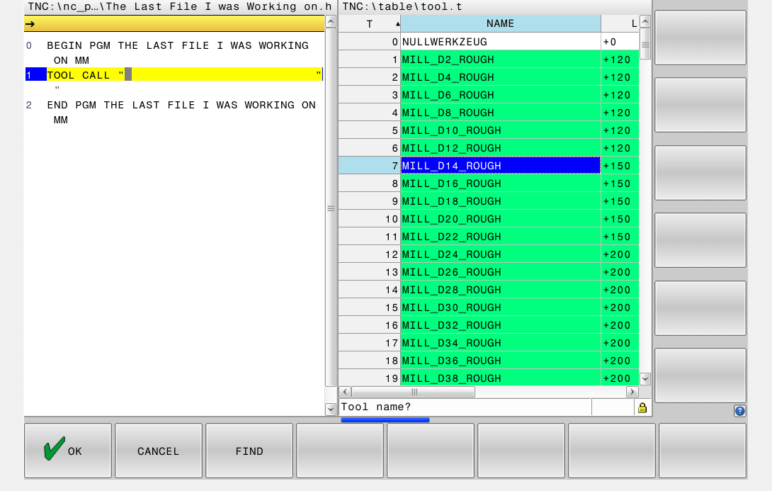

Tool Names
Using too names as opposed to numbers means you can select them directly from the tool table. This is a much quicker way.
After TOOL CALL press TOOL NAME
By pressing SELECT you can pick at tool straight from your tool list.
