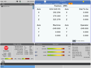

The position page, for example, can display the actual position while taking the tool length and tool offset into account.
Haas CNC control
Haas CNC control, Brilliant.
Mazak, Heidenhain and Siemens users can stop yawning at the back.
With some Fanuc controls, you can find yourself looking at positions that don’t include your tool length offset — and sometimes not your work offset either — leaving you scratching your arse and wondering what on earth is going on.
On the Haas, that problem has effectively gone away.
Haas CNC control, Love it.

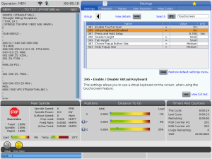

Another nice touch is that you can change a setting and have a proper QWERTY keyboard appear on the screen.
Needless to say, I turned that on immediately.

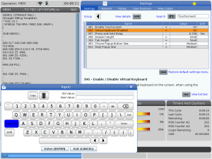

And here it is. Hold down any input key and it will appear.
