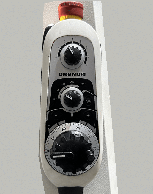

Something that annoys me about modern CNC machines is the rigorous protocol you sometimes have to follow to do the simplest bloody thing.
This machine definitely has a few of those little rituals.
I think I now understand the expression:
“When you know, you know.”
Because until you know, you haven’t got a fucking clue.
I was genuinely excited about working with this beast.
That excitement lasted right up until I couldn’t get the handwheel to work.
Fortunately, I always allow plenty of time to get back into using a machine I haven’t seen for a while.
Partly because machines have their own quirks.
Partly because controls change.
And partly because my memory now works like an old Windows computer with twelve toolbars installed.
A Message to DMG Mori
One day, I will rip my own bollocks off in temper and it will be your fault.
Yes, you know what I mean.
Some clever bloke decided the handwheel should stop working if the feed-rate potentiometer is set to zero.
One click up and it works perfectly. Wind it back to zero and no. The handwheel is having none of it.
The machine knows I am using the handwheel. I know I am using the handwheel. The handwheel knows it is a handwheel.
But the feed-rate knob is on zero, so apparently nobody is going anywhere. I can only imagine a meeting where somebody said:
“What this machine really needs is a completely silent way of making experienced engineers feel like absolute beginners.”
And everybody agreed. It has caught me out several times.
That is why grown men end up walking around workshops talking to themselves. It’s not drink. It’s not drugs.
It’s not the pressure of modern life. No. It’s fuckin handwheels.
Moan over. Probably.

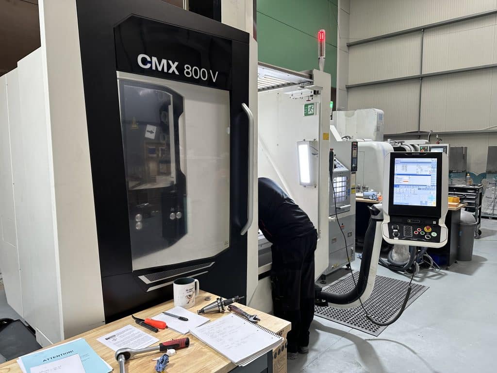

It Oozes Quality
Once you start using this DMG Mori vertical machining centre, it oozes quality.
Everything feels substantial.
Closing the door feels like closing a bank vault or the door of a 200 grand Bentley..
There is no rattling, flexing or wondering whether the handle is about to come off in your hand.
And when a part flies out at you, at least you know it’s the tool that will get it and not you.
That is reassuring.
Not as reassuring as clamping the part properly in the first place, obviously.
But still reassuring.
The working area is open and accessible. You can get near the job without leaning into the machine like you are trying to retrieve a pound coin from the bottom of a drain.
You can see what you are doing.
You can get a clock in there without dislocating a shoulder.
These things rarely appear in glossy brochures, but good access makes a massive difference when you are setting jobs every day.

The guarding feels substantial, visibility is good and you can watch the cutter without performing workshop yoga. Having a spinwindow really helps with visibility.
That matters when proving out a program. You want to see where the tool is going. Preferably before it gets there.
