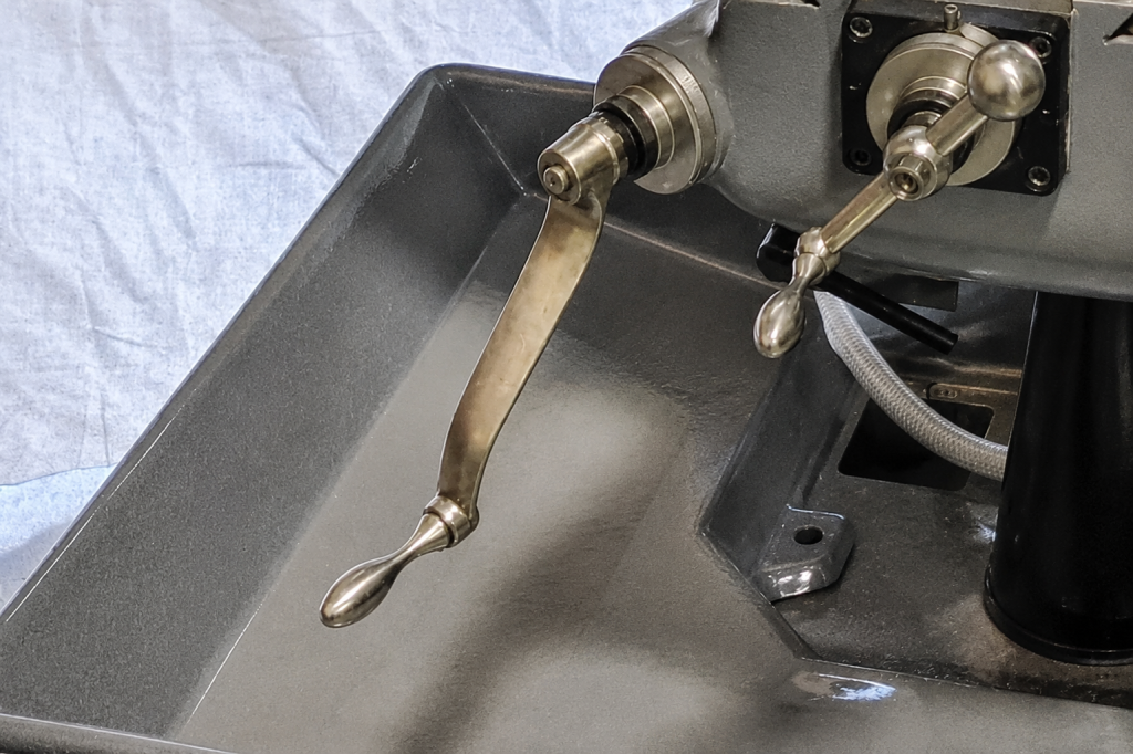

If that’s not enough you can move the whole table up and down. We call this the knee of the machine.
Always try to keep this high. That way your quill is not sticking out too much meaning you wont get vibration.
In these days of political correctness nobody wants to walk around with their quill hanging out now do they. I tried it in the Coop the other day and if it wasn’t for me hiding behind the meat counter I’d probably be in a lot of trouble.
The quill has it’s own digital readout and another handwheel. That means you can get more control of it and because there is a DRO (digital read out) on the Z you can drill holes to a very accurate depth.
How exciting is that?
On the KRV 2000 you wind the whole table upwards with this handle.
It comes off and turns around so it’s out the way. If you have bollocks then you’ll be glad of this because it can hit them.
Unless of course you want a budget vasectomy.

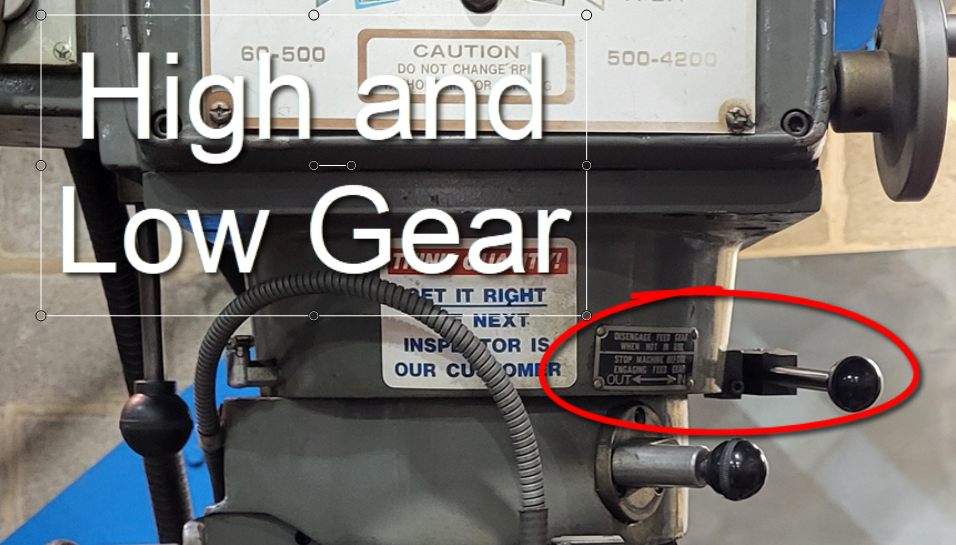

Speed Control Bridgeport BRJ and Similar
You stop and start the spindle here and adjust the speed on the right. Just turn it.
Make sure to change speed with the spindle running or you will fuck the machine.
Depending on which range you are in the actual speed is displayed left and right
When you stop the spindle if you pull or push the lever below you can apply a brake and stop the spindle quickly.
Rotate Lever to Change GearTo change from low to high gear rotate the lever on the right (see picture above). You may have to turn the spindle to make it drop into gear. Make sure it has dropped in or it will sound like a vicar driving a 1960s mini when you turn on the spindle. Crunch crunch.
Don’t you just love AI. Does anyone know if it can do porn (just asking) ?
In low gear FOR is forward and REV is reverse, obvious really but I know my audience.
In high gear REV is forward and FOR is reverse so it’s actually backwards.
Try and remember this if you don’t want sparks flying off your drill and a very hot part.
