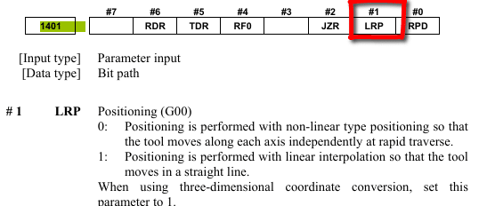

G00 Straight Line Fanuc Parameter 1401
Messing With Parameters Can Be Fatal!!!!!
Unlock Programs Fanuc Parameter, first of all you’ll need to go to the setting screen and change the parameter write box to a 1.
When you program a rapid move on a Fanuc control which ever axis has the shortest path will arrive first. This will give a dogleg type move and may result in a collision.
Changing parameter 1401 Bit 1 will make this into a straight line move.
