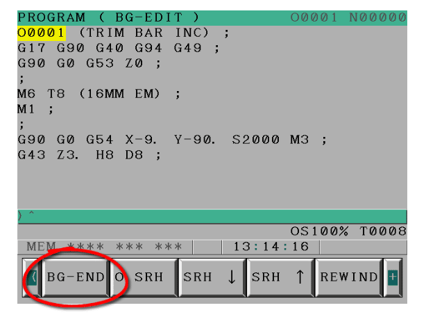

The main reason why I’m writing about background editing is because you can get locked into it by mistake. It’s so easy to press the wrong button and end up stuck in background edit. It’s like the Guantánamo Bay of CNC Programming, very hard to escape from.
It’s Useless But Here is How To Use It
You will be in Memory or Auto mode and your programme is running merily producing your parts.
First of all press BG-EDT
Once it’s active it’s there at the top of the screen
You can now go to your directory and call your programme to edit in the usual way. Enjoy yourself editing your programme or even create a new one.
Don’t Hit Reset
There is only one thing you must not do in background edit. That is to hit reset as it will stop the machine.
Try to get into the habit of using rewind not reset.
Rewind
Background Edit (Fanuc)
- You can’t Press RESET
- You can’t edit the programme that’s running.
- You can’t get to MDI screen
- Some other screens won’t work.
- Most edit functions will work.
As I said before you can get stuck in background edit it’s easy you just need to press this.
When I’m training people on Fanuc Controls I always teach them about Background Edit. Even if you don’t use it, one day you’ll press it by accident. It could take you a long time before you realise what you did
