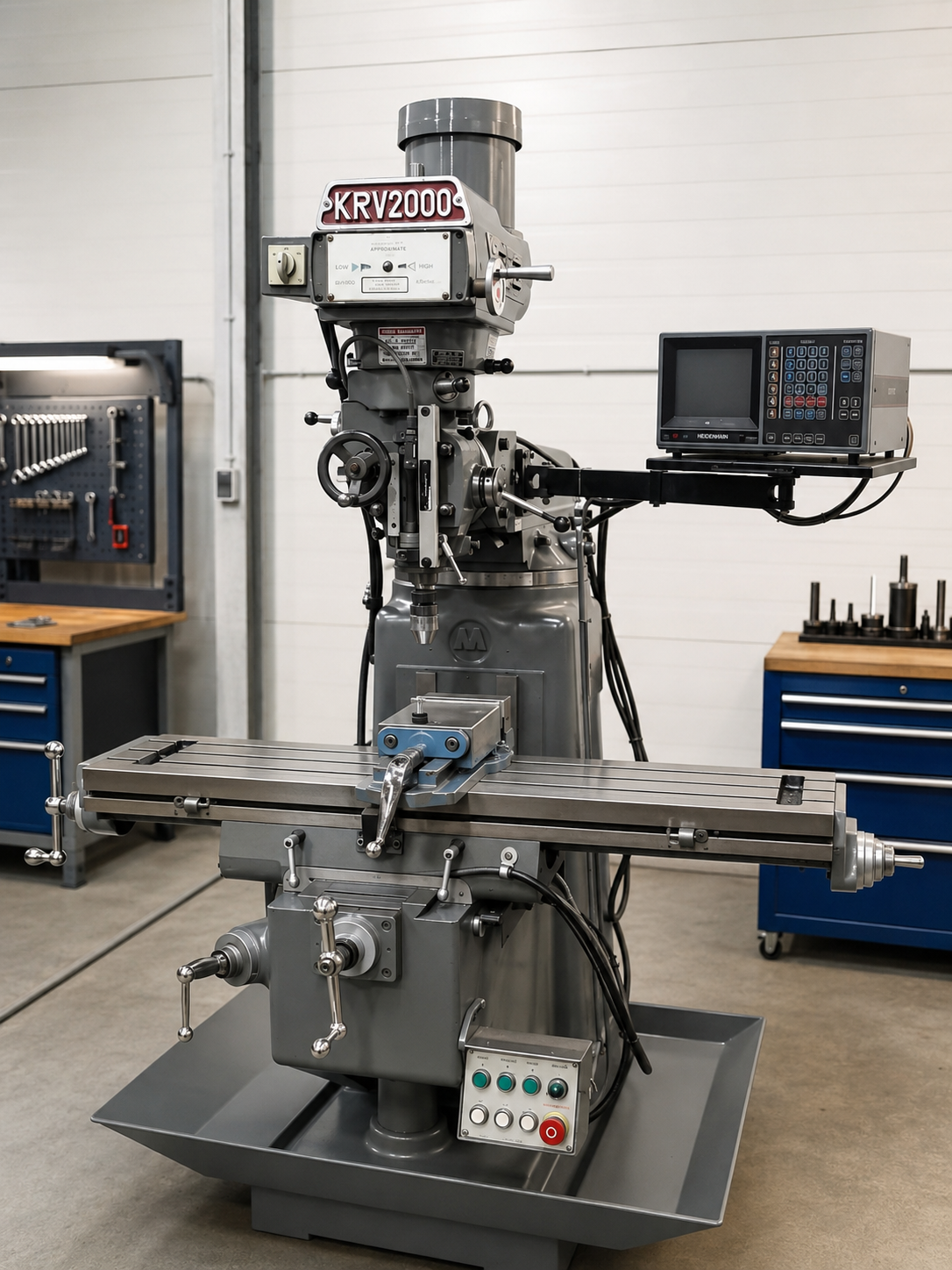

The XYZ KRV 2000 also branded as King Rich is what is commonly known as a turret mill it is an incredibly versatile machine. This machine can get into all the nooks a crannies that other machines can only dream of. It has an Acurite Mill Vision digital readout. It’s a bit like the gynaecologist who repainted his hall through the letterbox.
My machine had the Acurite DRO this is the Acurite Mill Vision and for it’s age it still packs a punch as you will see later in the article.

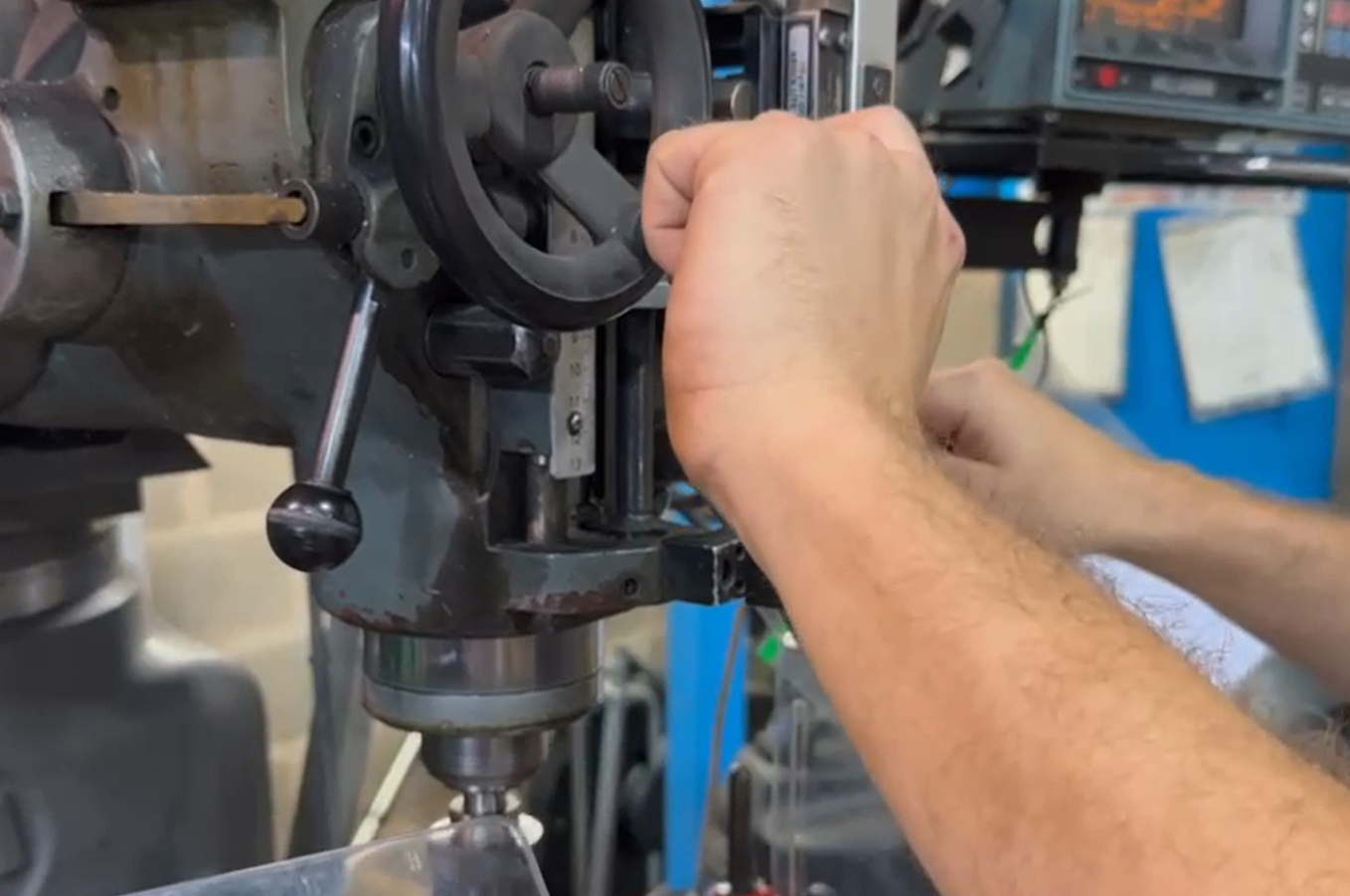

The quill has it’s own digital readout and another handwheel that means you can get more control of it and because there is a DRO (digital read out) you can drill holes to a very accurate depth.

Some bloke moving the quill with the handwheel.

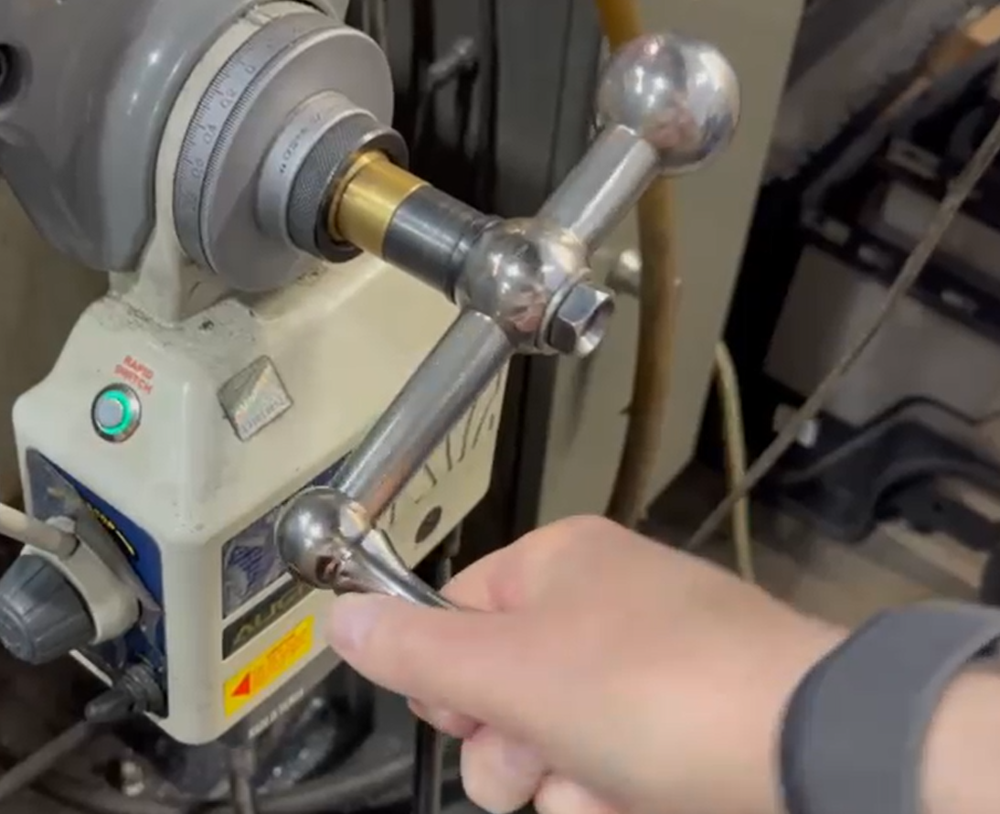

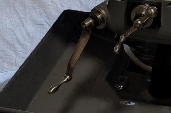

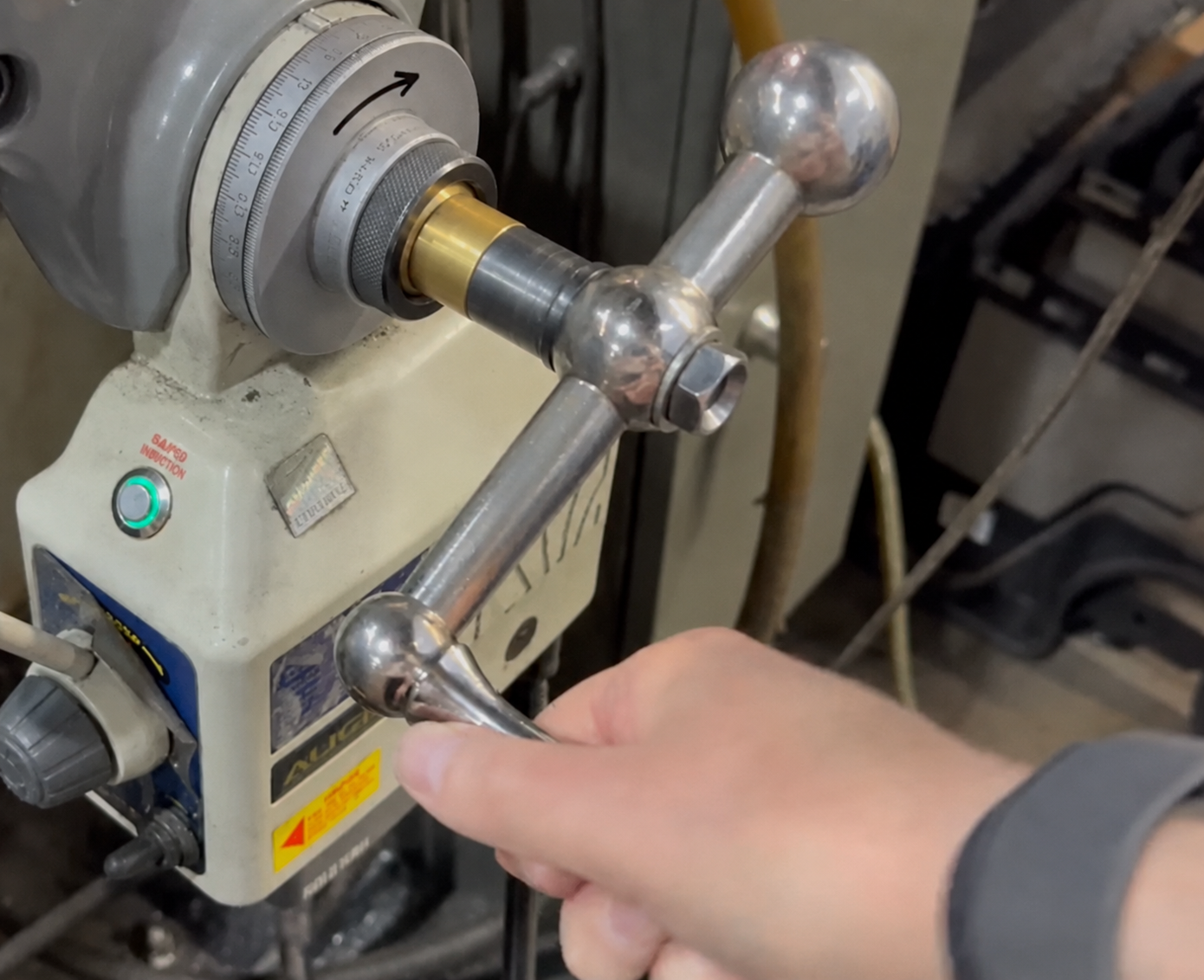

On the KRV 2000  you can also wind the whole table upwards with this handle.
It comes off and turns around so it’s out the way. If you have bollocks then you’ll be glad of this because it can hit them.
Unless of course you want a budget vasectomy.

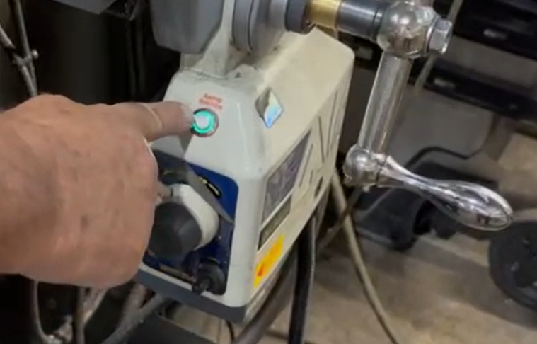

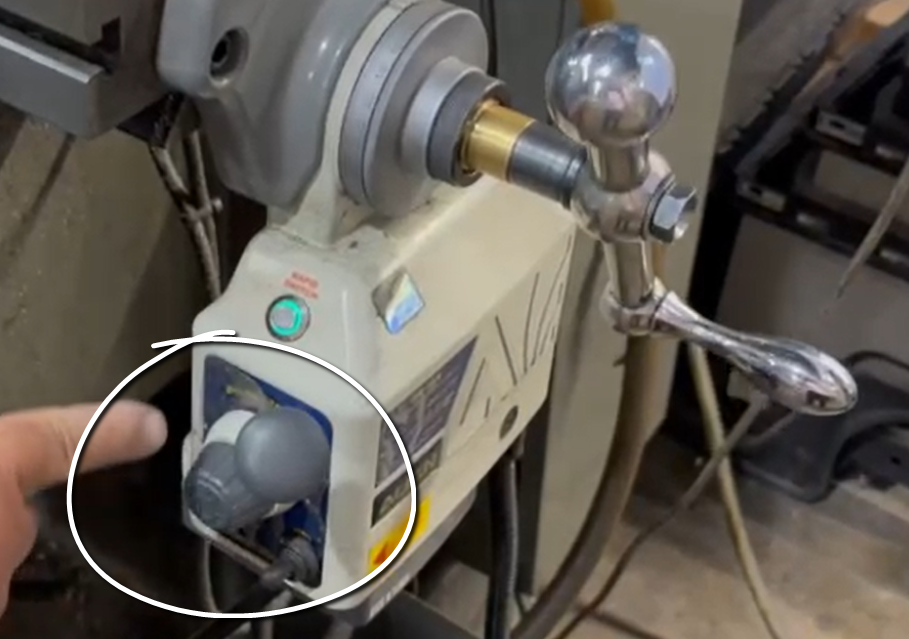

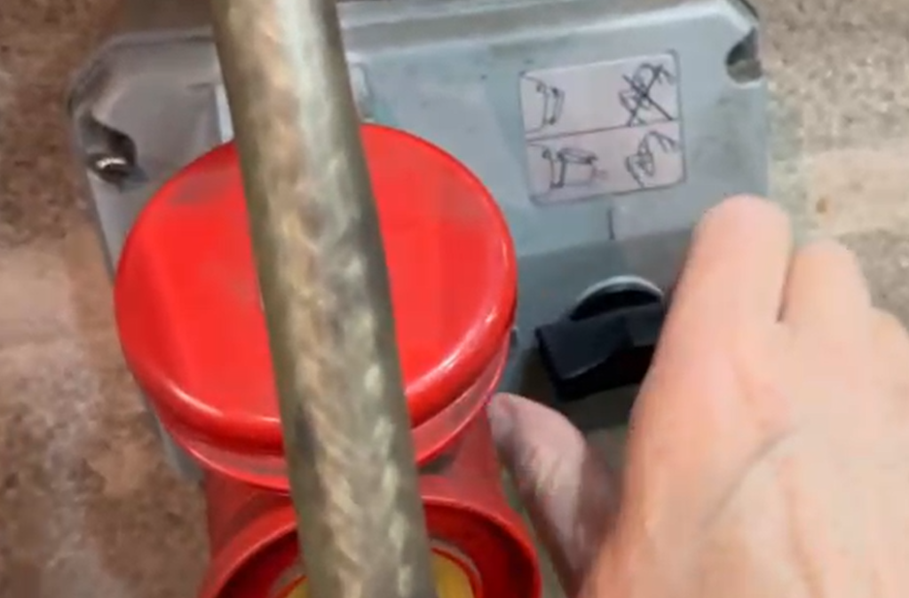

Just press the green button to speed things up on your KRV 2000 . This is a rapid button so be careful not to shit your nickers when it moves.

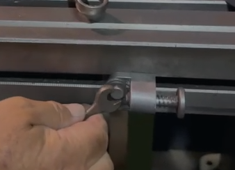

The table has two handy stops which you can lock up so that you can machine to an exact point. These will automatically switch off your feed if you engage it.
Just undo the nut below to move them. Sorry about the shitty little spanner. Please use a ring spanner.

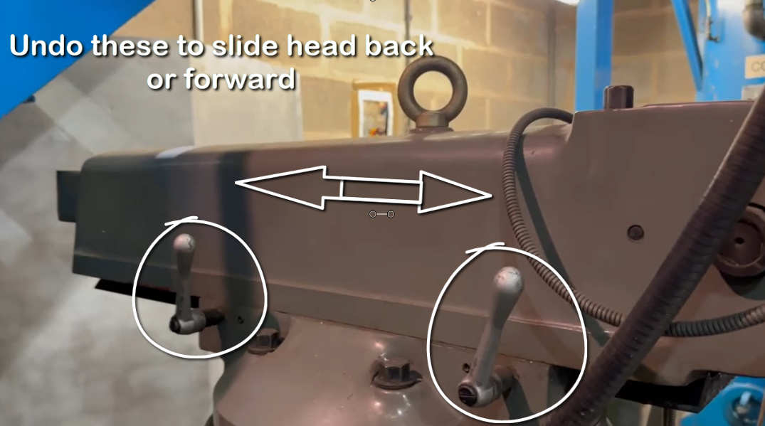

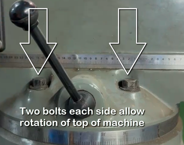

As I said this machine can get anywhere, it can reveal your darkest secrets. The whole milling head can rotate and move forward meaning you can put massive parts on the table. Watch it don’t tip up. (Not joking there)
KRV 2000
So this means the whole of the top of the machine can slide back and forward as well as rotating. This is rocket science.

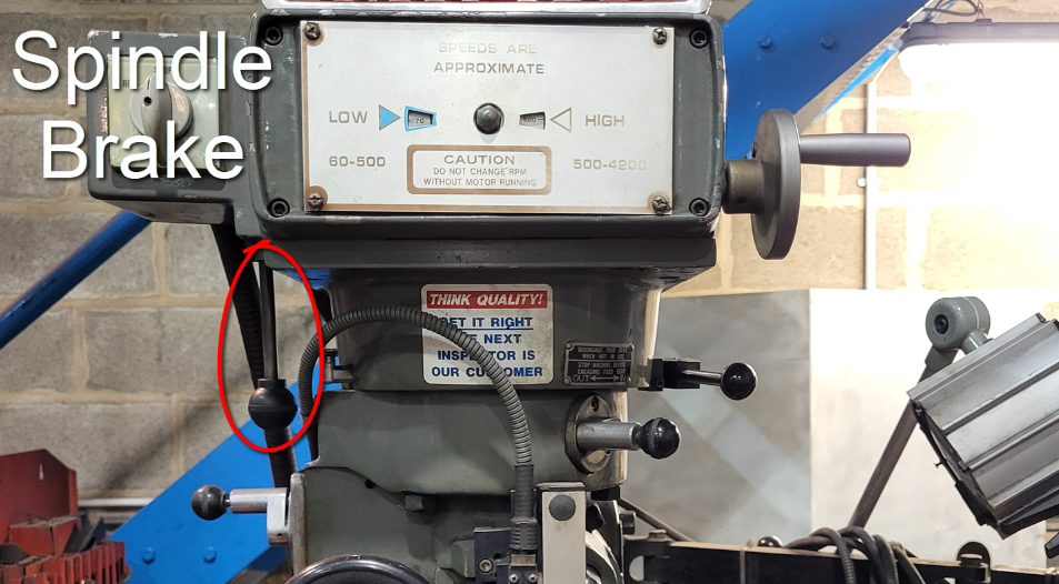

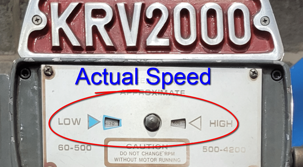

Speed Control Bridgeport BRJ and Similar

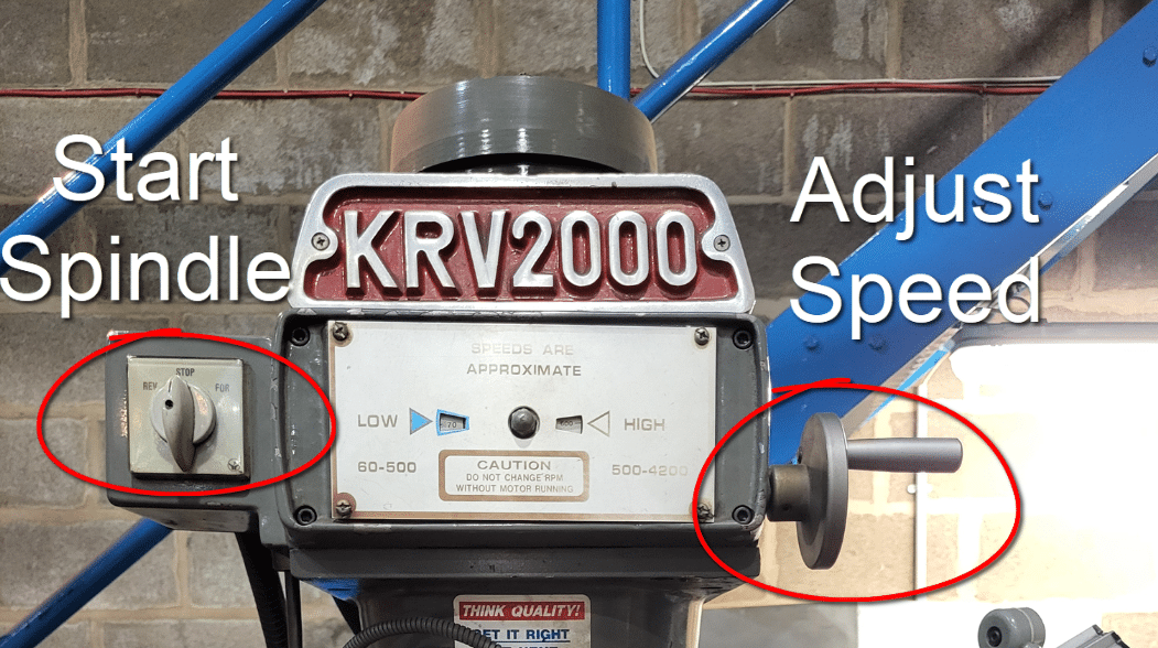

You stop and start the spindle here and adjust the speed on the right. Just turn it. Not without the spindle running or you will fuck the machine.
Depending on which range you are in the actual speed is displayed left and right
When you stop the spindle if you pull or push the lever bellow you can apply a brake and stop the spindle.

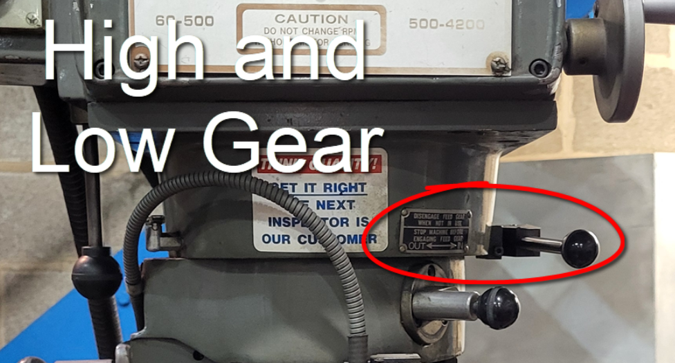

To change from low to high gear rotate the lever on the right. You may have to turn the spindle to make it drop into gear. Make sure it has dropped in or it will sound like a vicar driving a 1960s mini when you turn on the spindle.
Don’t you just love AI. Does anyone know if it can do porn (just asking).
In low gear FOR is forward and REV is reverse, obvious really but I know my audience.
In high gear REV is forward and FOR is reverse. Try and remember this if you don’t want sparks flying off your drill and a very hot part.

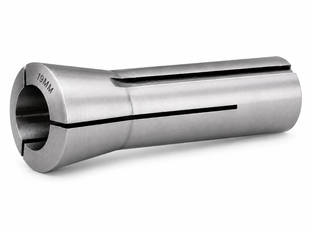

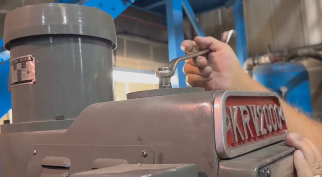

This machine has what is called an R8 taper. Collets and chucks are held in this taper and pulled up with a draw bar. These are used on all turret mills similar to the Brideport BRJ.
The draw bar is at the top of the machine and you will need a 19mm ring spanner. Remember to remove the spanner before starting the spindle. Believe me I’ve seen it done and its not pretty.
KRV 2000

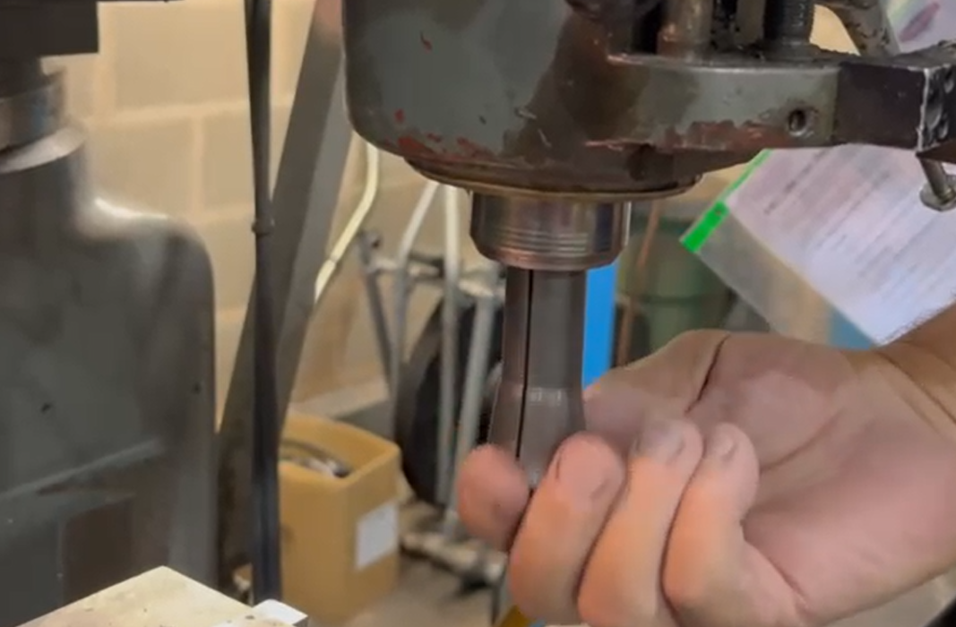

Undo this bolt then give it a light tap.
Collet will drop and you can unscrew it.

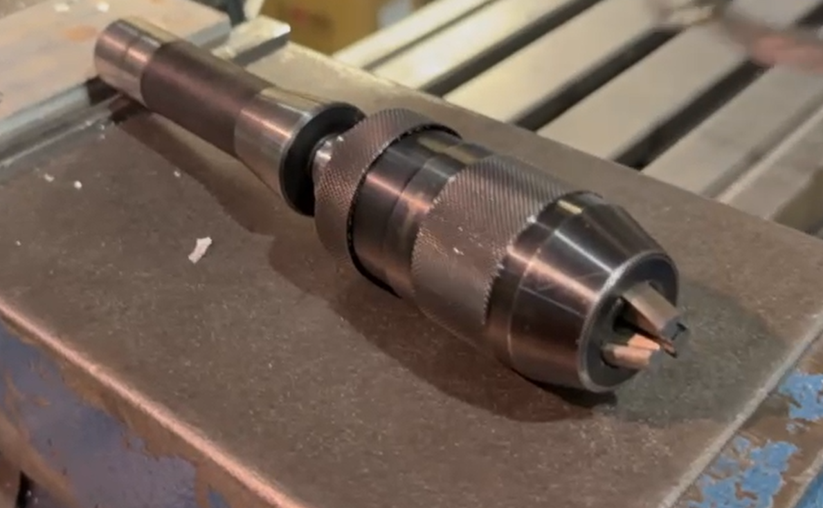

This is an R8 hand chuck. As used on Brideport BRJ and similar machines
Turret Mill

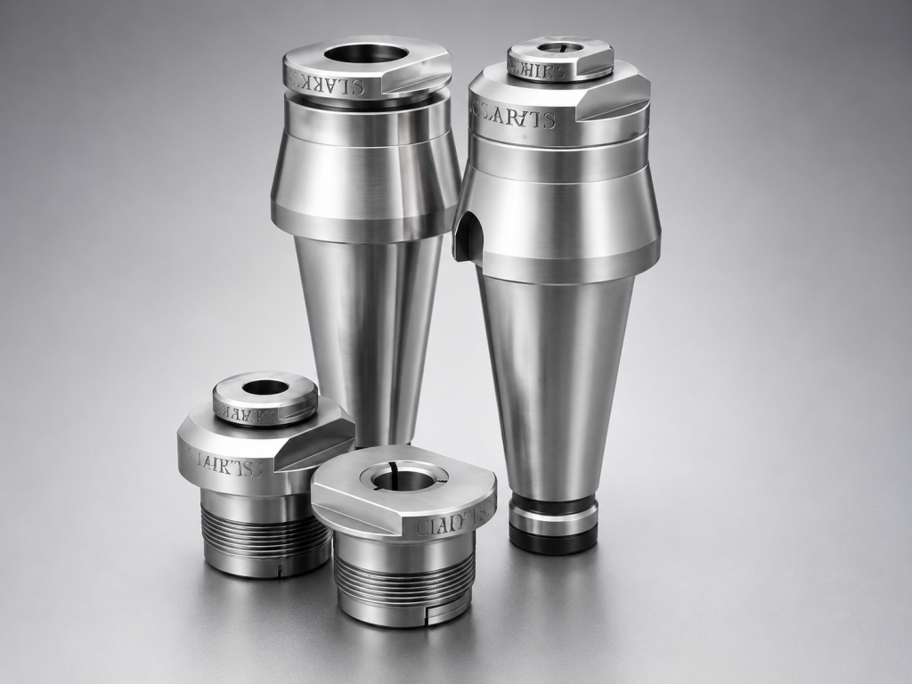

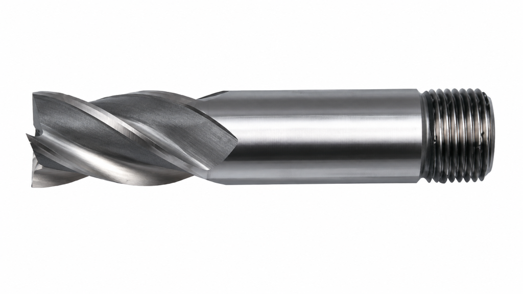

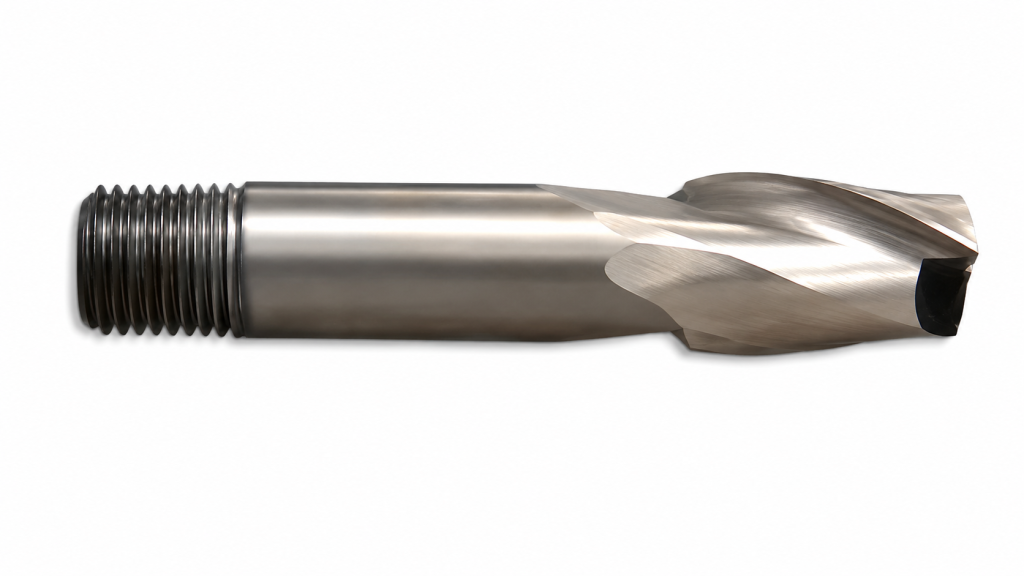

This can be used for drilling and spot drilling. It is not designed for any side load so if you try to put a slot drill or end-mill into it they will spin and pull out.
Use a Clarkson Autolock milling chuck, if you have them. Alternatively use a collet. The Clarkson Autolock chuck is designed for screwed shank tools. They will not pull out and are really rigid.
Older high speed steel end-mills will not cut downwards.
Slot drills which only have two flute will cut downwards like a drill and side-ways.

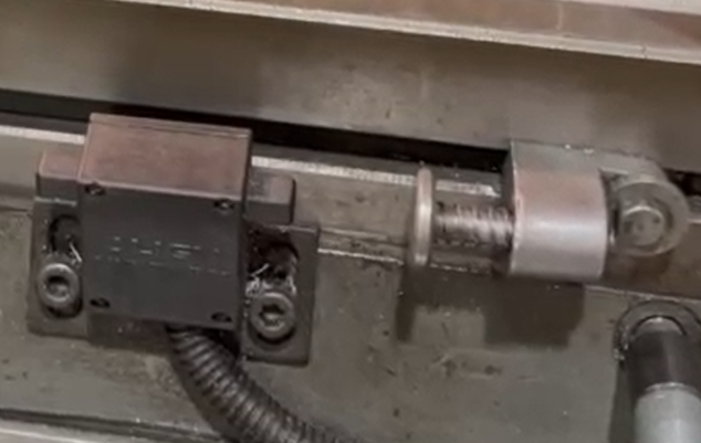

Fuck it. You have a DRO (digital readout) this has a glass scale that reads straight off the table. I always read the correct position.

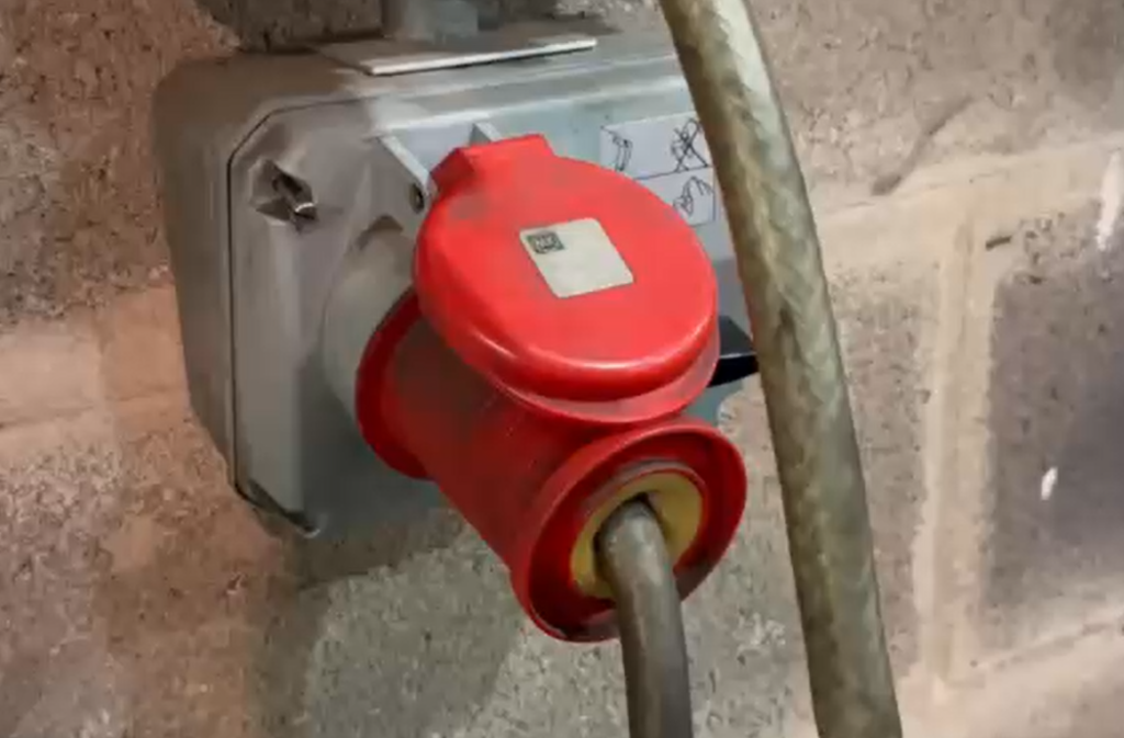

You will need to plug it in

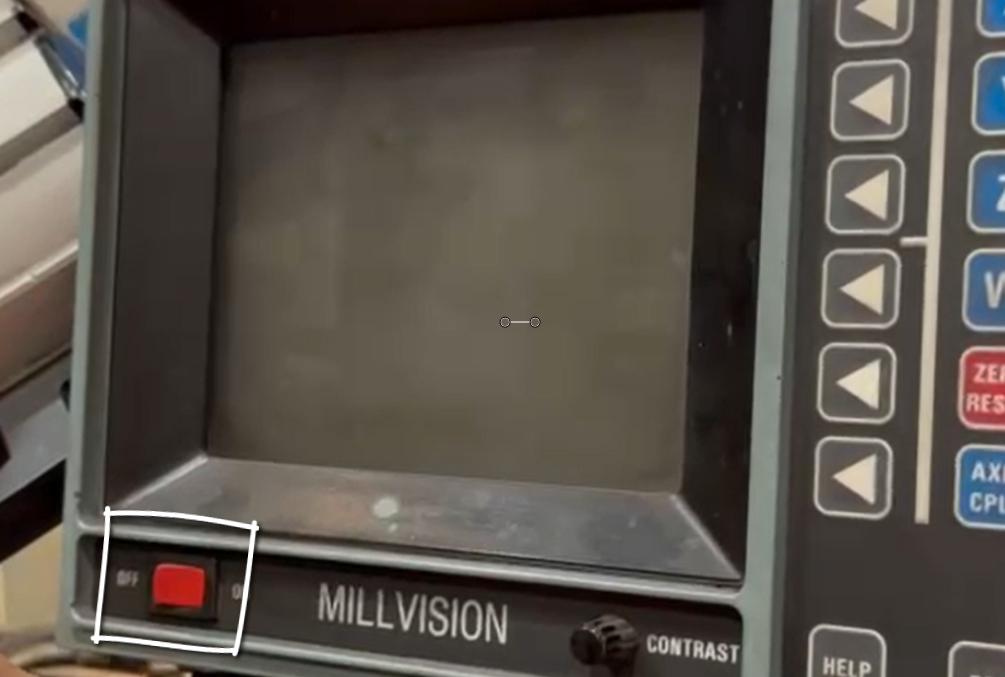

And switch it on.
Turret Mill

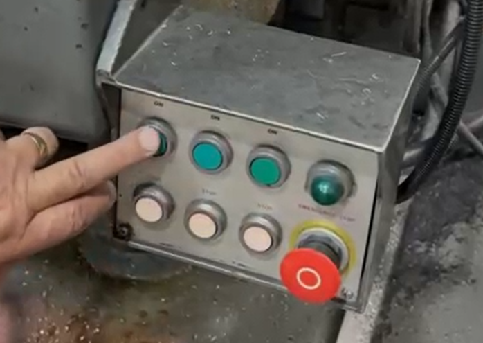

Then turn on the all the motors, press each green button.

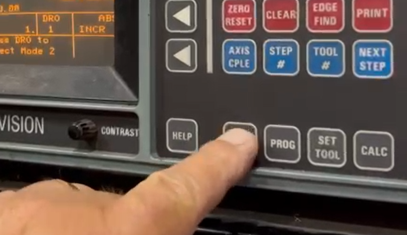

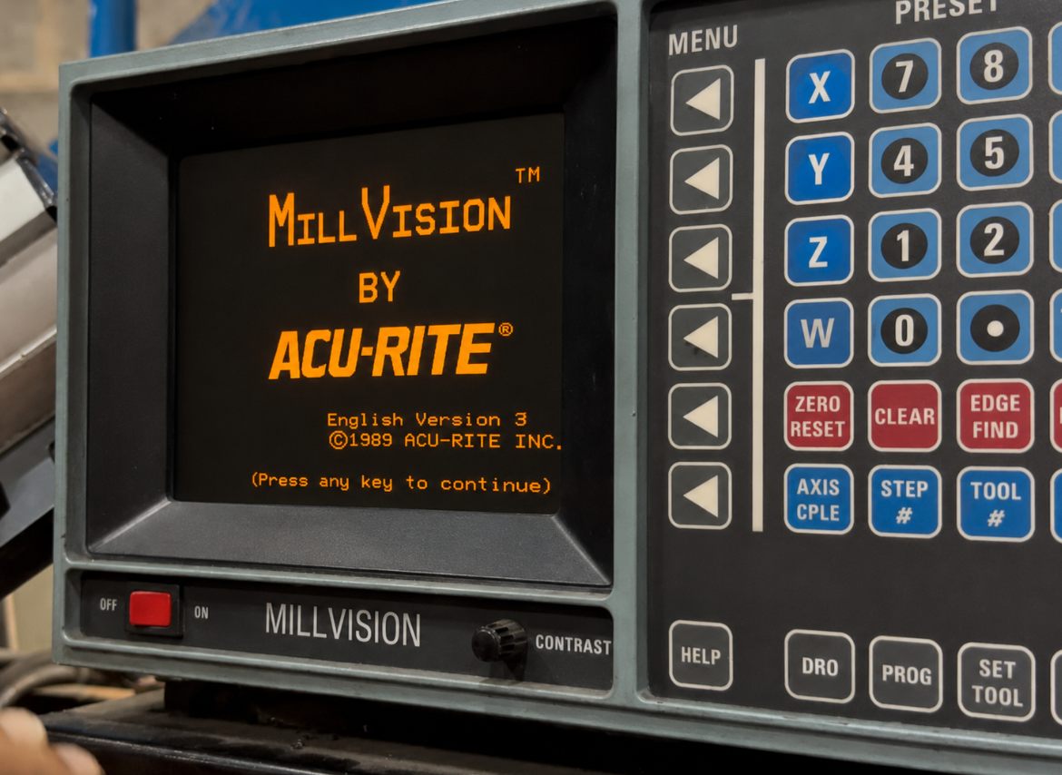

Now turn on the Anilam Millvision DRO
Acurite Mill Vision
This will take a while to come on.
Press any key to continue, then press DRO.
Acurite Mill Vision
You can now zero the DRO.
Acurite Mill Vision

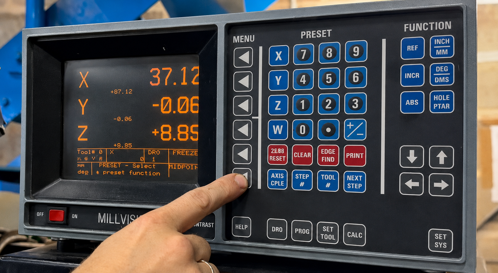

This control is like the usual DRO (digital read out) you can zero it and send it to any position. The Accurite Mill Vision DRO has a few tricks up it’s forty year old sleeve. Yes clever shit could be done even back then.

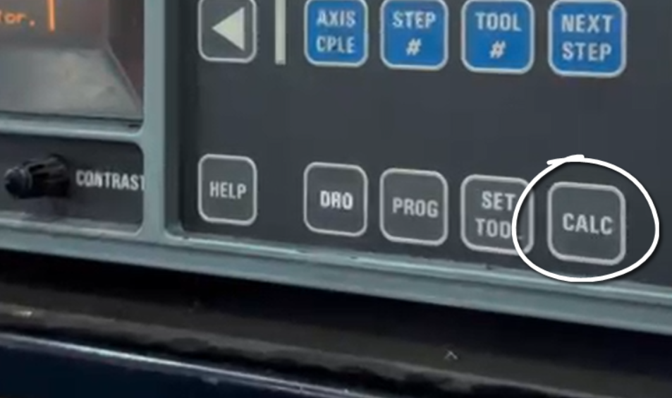

KRV 200 Even Has A Built In Calculator
Yes you heard me a built in calculator.

Yes this Acurite Mill Vision has a thing-a-me-jig. It can calculate angles. You just position the machine to one point and it records it, then go to a second point. It records that and then tells you the angle between the two point. Wow that’s fuckin awesome. Probably useless but I love it. Sure I’ll find a use.
