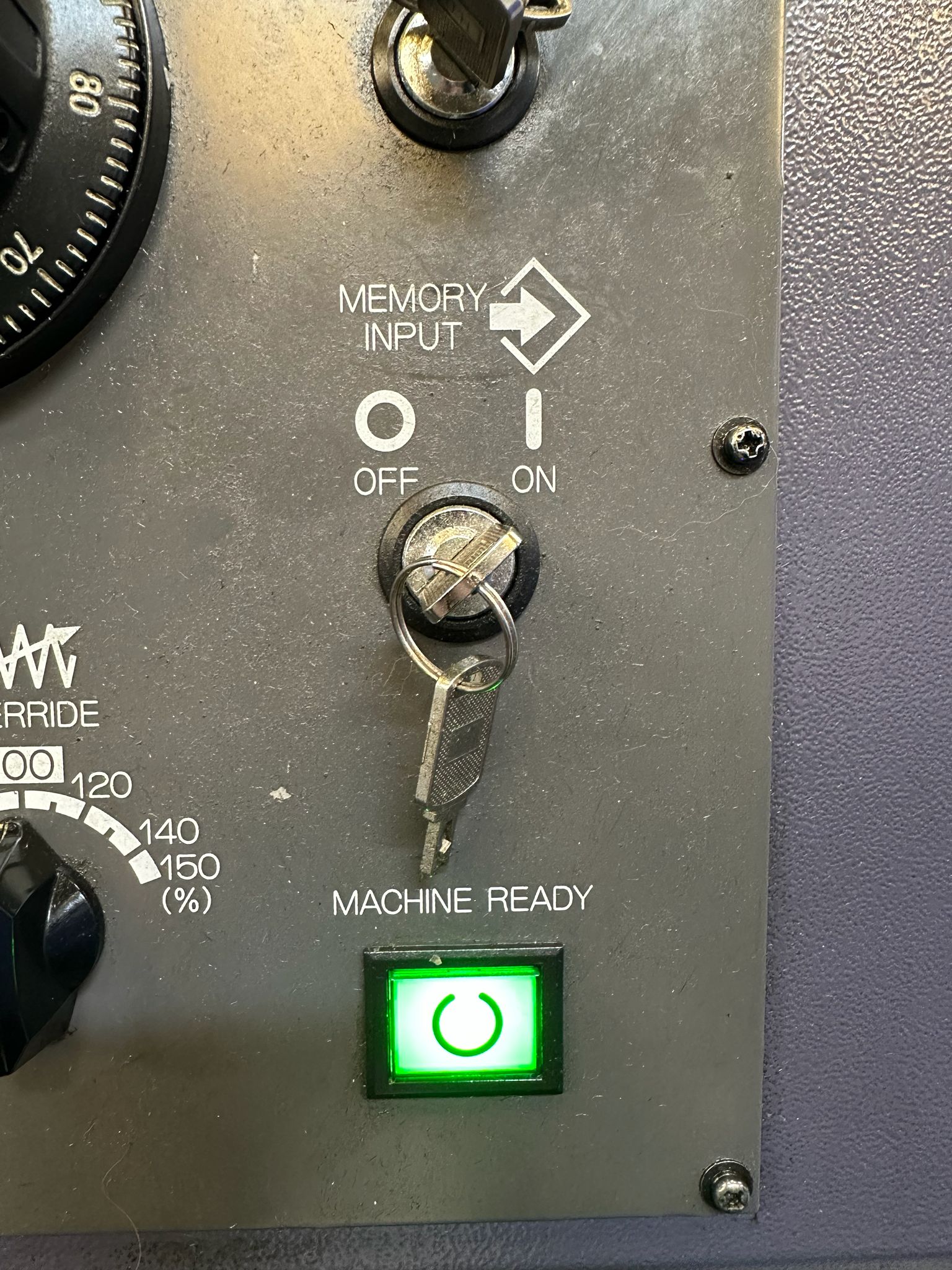

You will need your keyswitch in the on position to allow any kind of editing
In the off position below you will not be allowed to edit

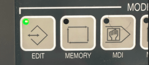

First of all you need to be in the EDIT mode.
how to Make a Program Active Fanuc 0i-TF

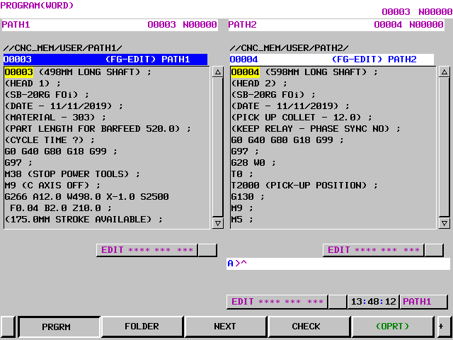

Press PROG to view your program.
How to Make a Program Active Fanuc 0i-TF

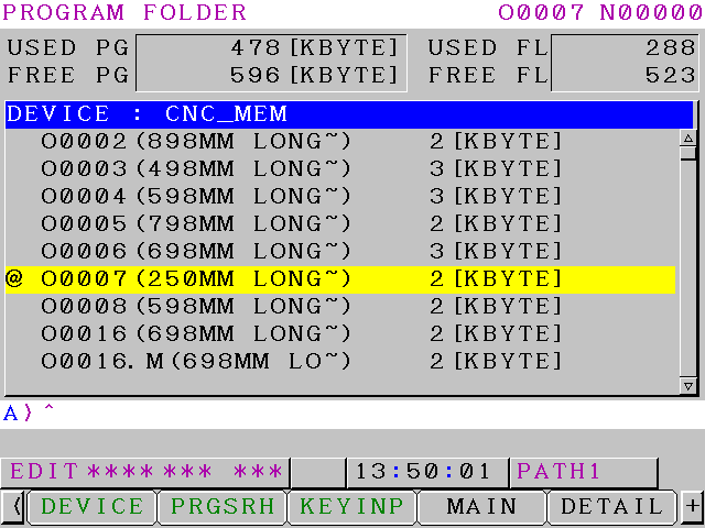

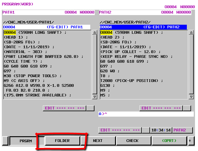

Now press FOLDER to see a list of programs.
Use your cursor to move down to your program.
Press the OPRT for more options
Now press MAIN to make your program active
The @ or “at” symbol means this is the active program. Program O0007 is now your active program.

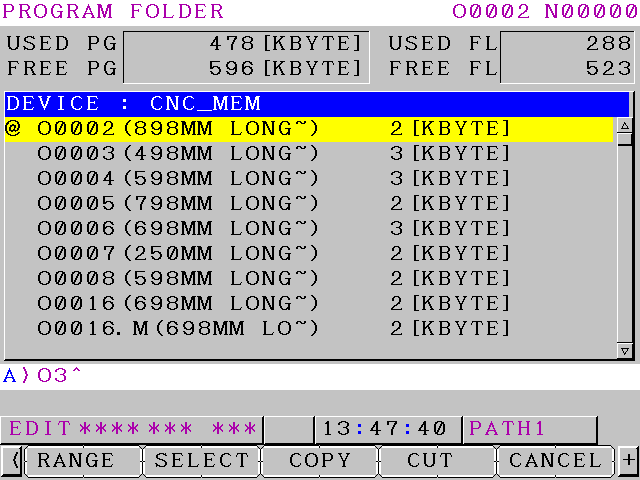

Another way is to type in the number of the program you want to make active O3 or O0003 for program 3
Press your lower or upper arrow keys and this will become active
Program 3 will now be displayed and is your active program.
