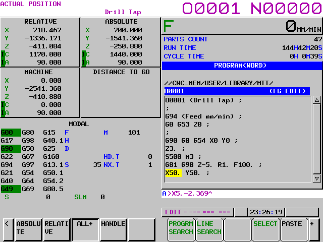

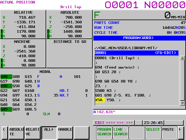

First of all input your calculation which can be part of your X, Y or Z figures.
Fanuc Calculator
So if I wanted to subtract 2.369 from my X value of 5 then I just input it.
Fanuc Calculator
Now press your SHIFT key (mines a bit bent).
Fanuc Calculator
Then press the CALC/ALTER Key
Fanuc Calculator
Voila, down in the buffer you magically get your answer.

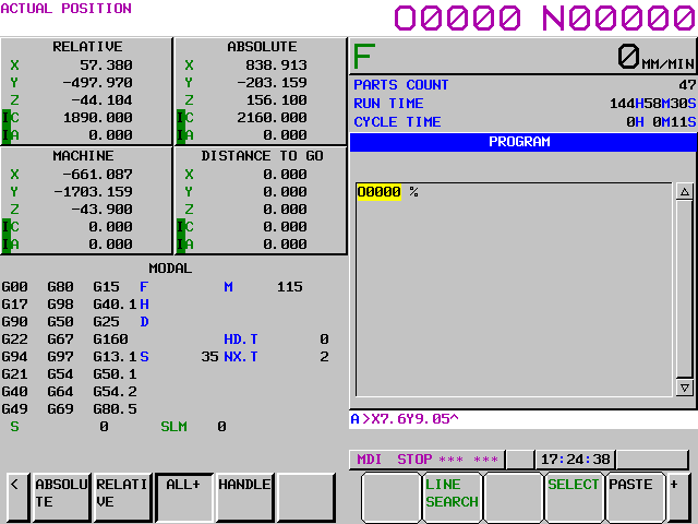

Fanuc Calculator
You can even do calculations on two or three axis at once look at the example below.
Fanuc Calculator
Fanuc Calculator
Fanuc Calculator
Down in the buffer you get your answer ready to use.

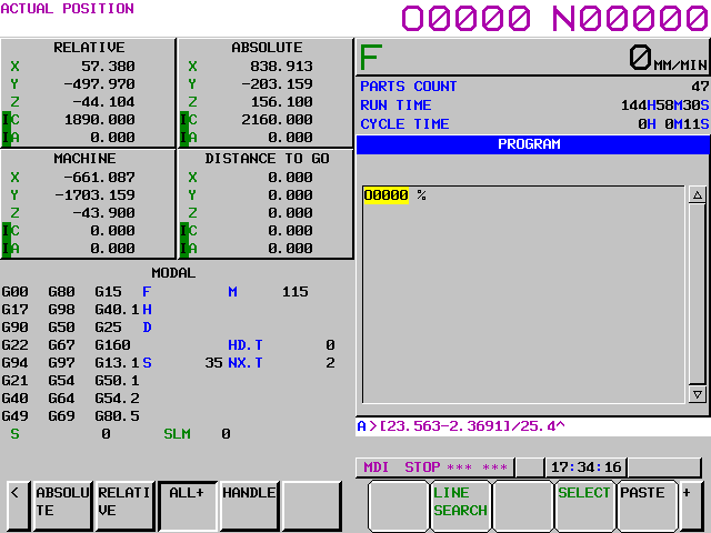

To use it as a regular calculator, type in as below.
Fanuc Calculator
Same again for the answer
Press your SHIFT key.
Press the ALTER Key
Fanuc Calculator
Fanuc Calculator
Fanuc Calculator, oh and guess what?
You can even do simple triangle calculation (you know all that trigonometry shit.)
Yes you know the score now SHIFT then the ALTER key
How exciting is that, you might have to get rid of some of those extra numbers but you get it now.
