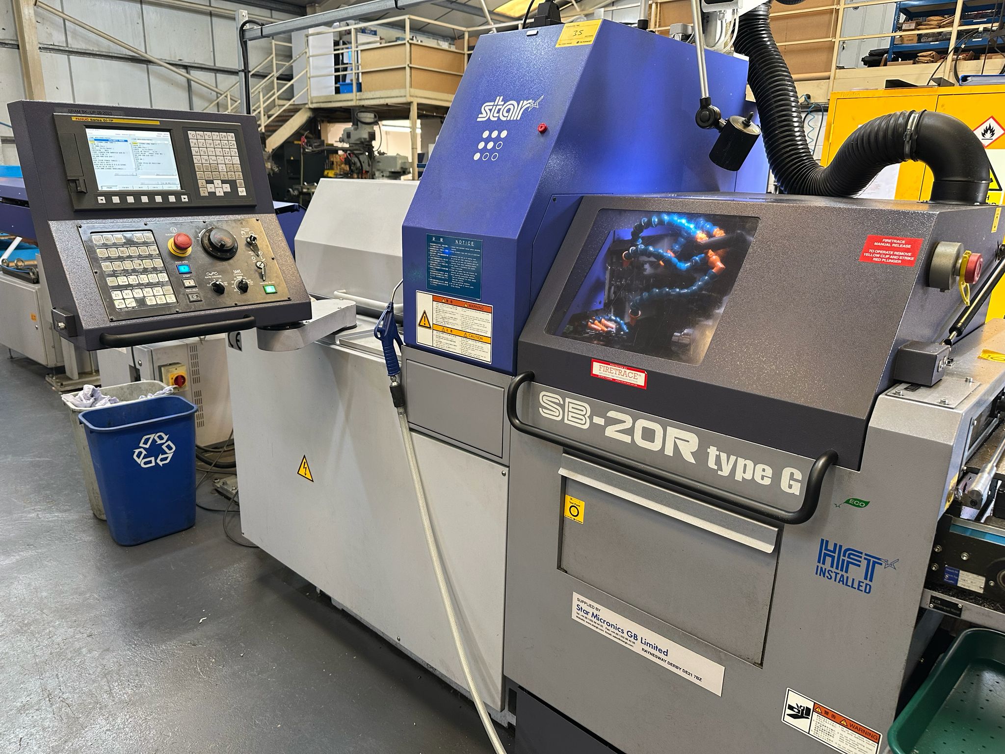

This step-by-step guide shows how to copy a program on a **Fanuc 0i-TF** control, specifically on a **Star SB-20R Type G** sliding head lathe, which uses a dual-path (two-channel) setup.

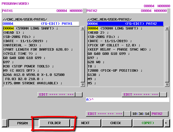

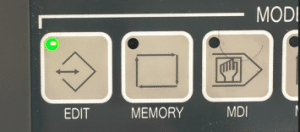

Edit
First thing we need is to get in the EDIT mode.

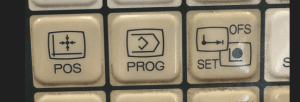

Then press your PROG button.
Your program will now be displayed.

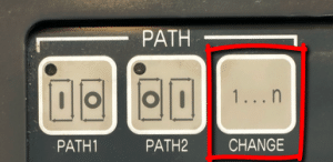

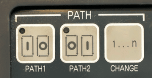

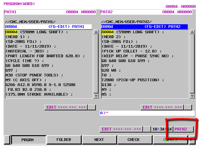

Because this machine is a sliding head machine running two simultaneous channels you have to sect a path.
First of all turn off the path buttons.
backup programs Fanuc 0i-TF
Just press them. The path (channel) you are on will highlight in blue on the screen. It will also show in the right hand corner.
Copy programs Fanuc 0i-TF
Press this button to switch from one path to the other.
Don’t forget that this machine has two independent sets of programs so each path will have its own programs.

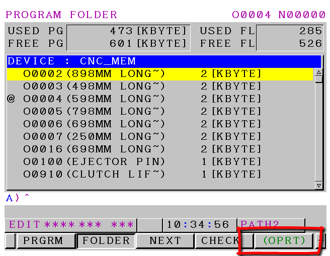

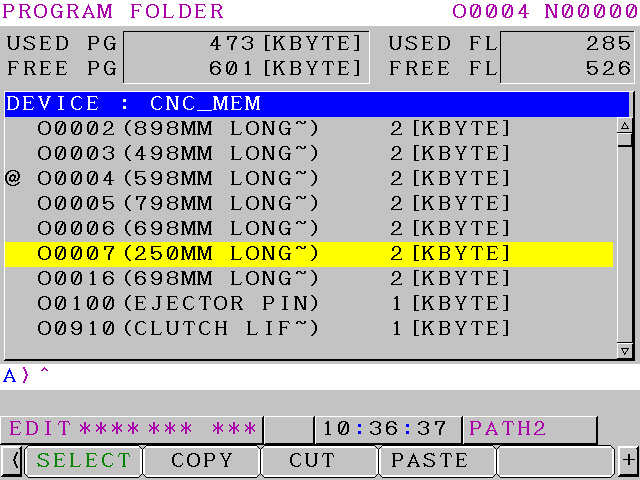

Now press FOLDER to display the programs.

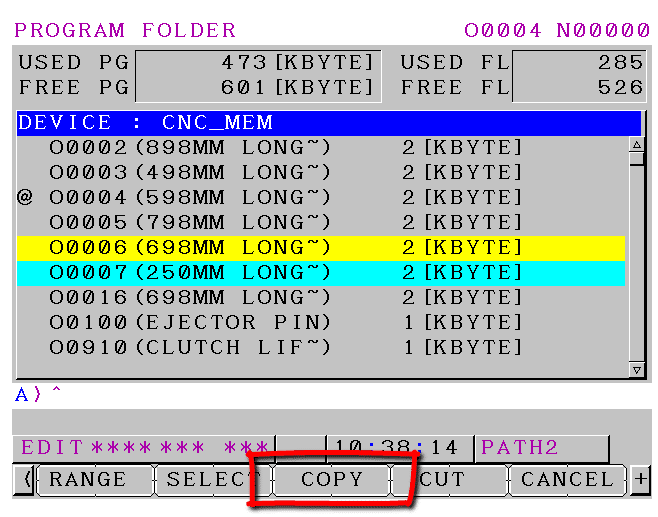

Cursor up and down to find the program you want to copy. Press OPRT for more options.

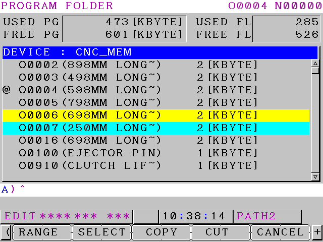

You can now press the green SELECT button to give you the selection choices.
If you move up or down you will see that your program is highlighted in blue. You can use the RANGE button if you want to copy more than one program for example to a USB stick.

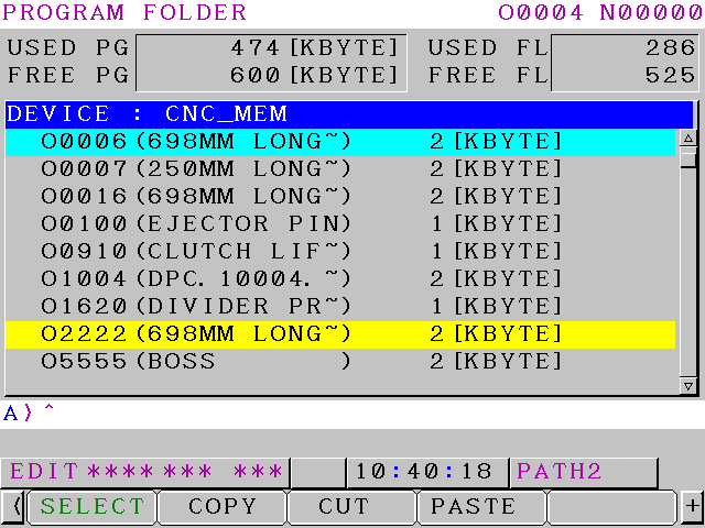

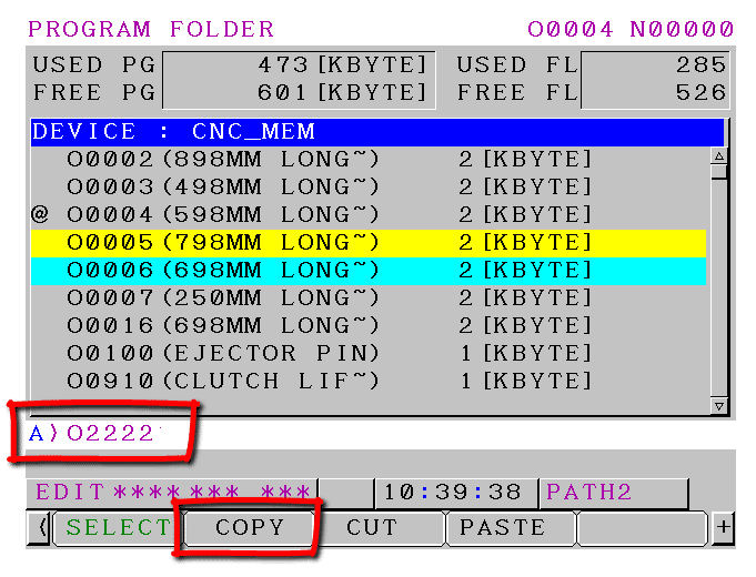

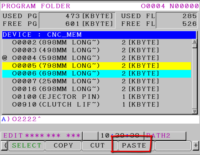

You now need to press COPY and this will put your program onto the clipboard.

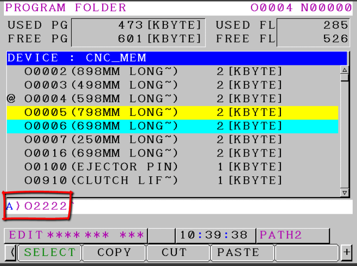

You can now type in the number of the program you need to copy it to. In this example its program O2222
If you move your cursor down you will see your new copied program.
