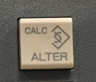

Fanuc Calculator, did you realize you had a calculator on your Fanuc control?
On the Fanuc Oi control this is what you do to use the calculator.
Just check the buttons before you get too excited you might not have it.
Your ALTER key should look like this.
First of all input your calculation which can be part of your X, Y or Z figures.
So if I wanted to subtract 2.369 from my X value of 5 then I just input it.
Now press your SHIFT key (mines a bit bent).
Then press the CALC/ALTER Key
Voila, down in the buffer you magically get your answer.
