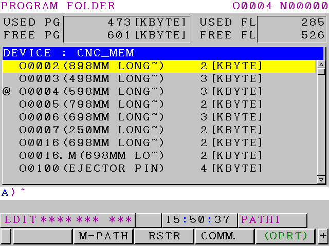

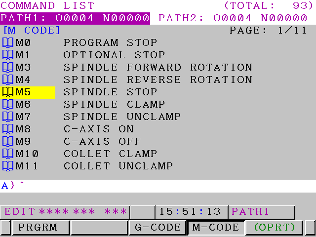

Explain M Codes and G Codes Star SB 20-R, the Star SB20-R has a Fanuc Oi TF control. It is configured especially for the Star machine.
Being a sliding head machine you get loads and loads of G codes and M codes even codes like M8 and M9 coolant on and off are different on this machine.
As I always teach people it is a good idea to put explanations on all your M codes so that you can easily see what they mean when going through programs.

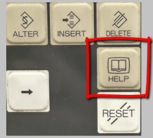

To the rescue comes this screen

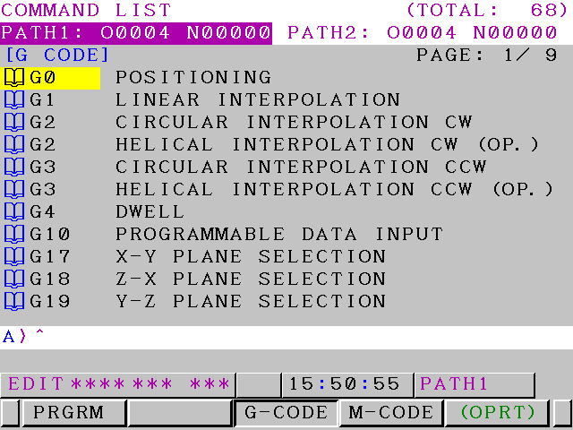

Press COMM this will take you to this screen.

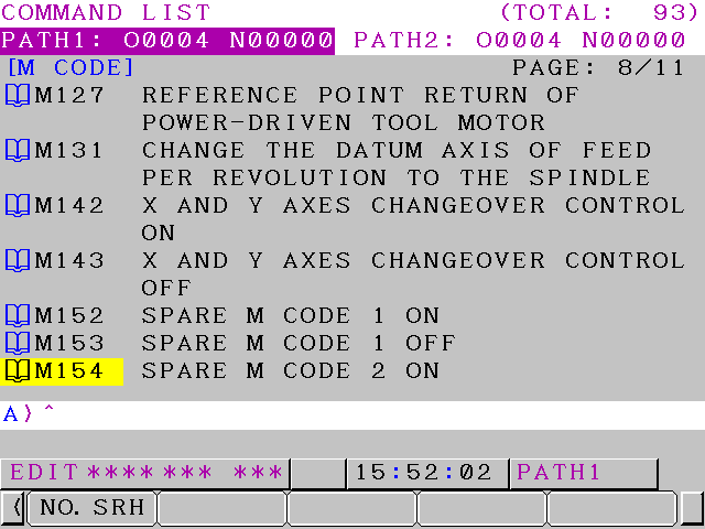

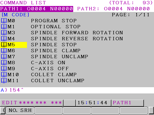

You can now search for any M code that you want. Input the number for example below 154 then press NO. SRH.
This will take you straight to that M code.

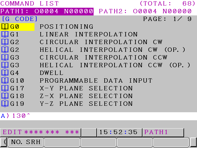

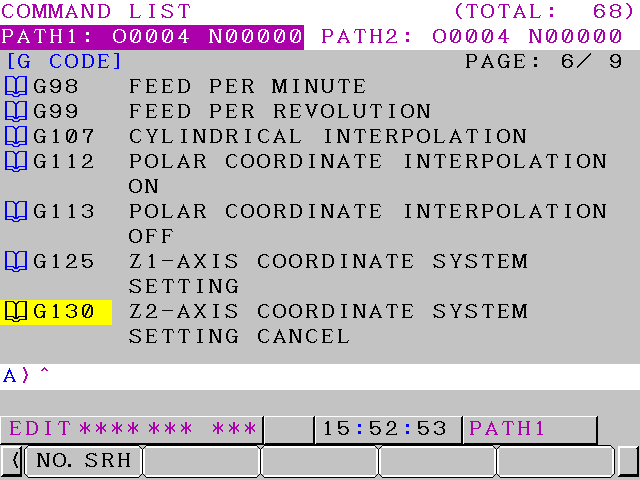

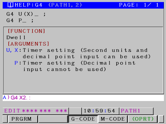

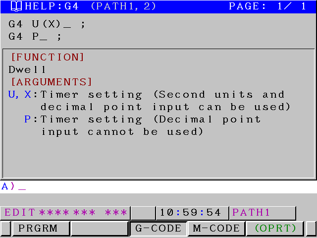

You can do it with G Code too.
Just input G code number here for example is G130
Press NO.SRH and you get to your explanation.
