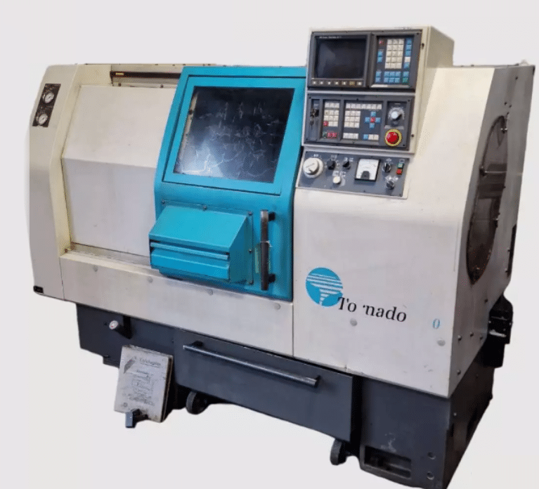

A visit to Halesowen to train on this beast. Nice simple two axis Colchester Tornado 90, this guys got six, mmmm.
This one has the following:
  • 12 station turret, just about enough.
  • Fanuc 21i T and it’s got Macro too, lovely.
  • Absolute encoders, useful no zero return required
  • 4000rpm spindle with a collet chuck
  • Bar-feeder (hydrafeed)
  • VDI turret these are great for accurately and quickly changing tools
  • This particular machine has a 42mm bar capacity.

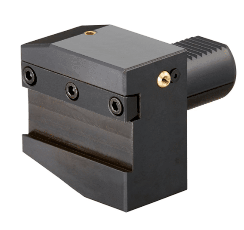

VDI
No it’s not a sexually transmitted disease, it’s that funny round thing with a pattern on at the back of the tool.
If you have this you’ll love it because it means you can quickly change a complete tool holder and it repeats really accurately.

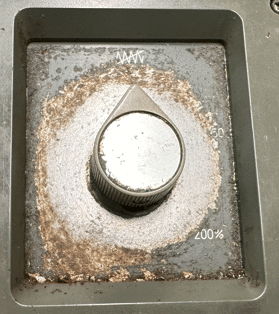

There is no separate rapid override on this Colchester Tornado. It’s just one control. A bit strange and scarry in equal measures until you get used to it.
I actually got to like it in the end.
Colchester Tornado
No markings at all on ours, welcome to the world of old machines. Anyway it overrides your rapid and your feed rate all in one dial.
Just reember to leave it at 12 o’clock.
