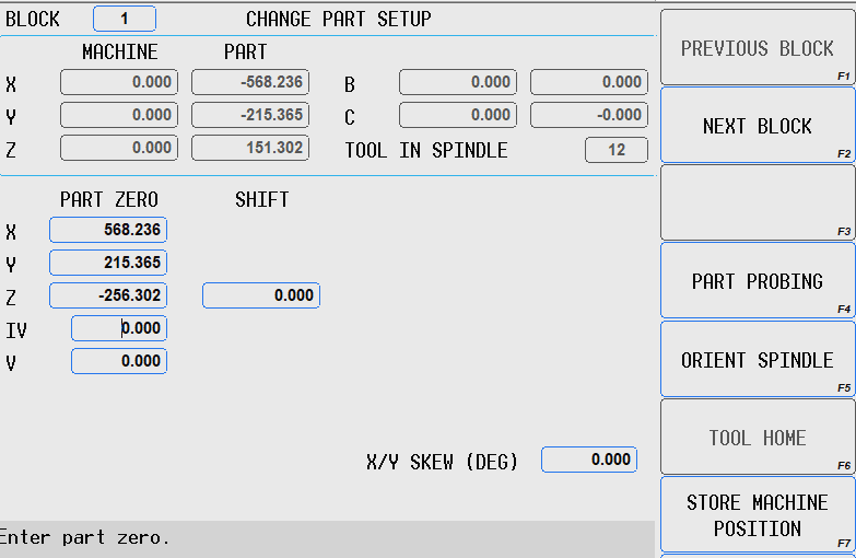

Hurco CNC Training, Part Offset Buried in the Program

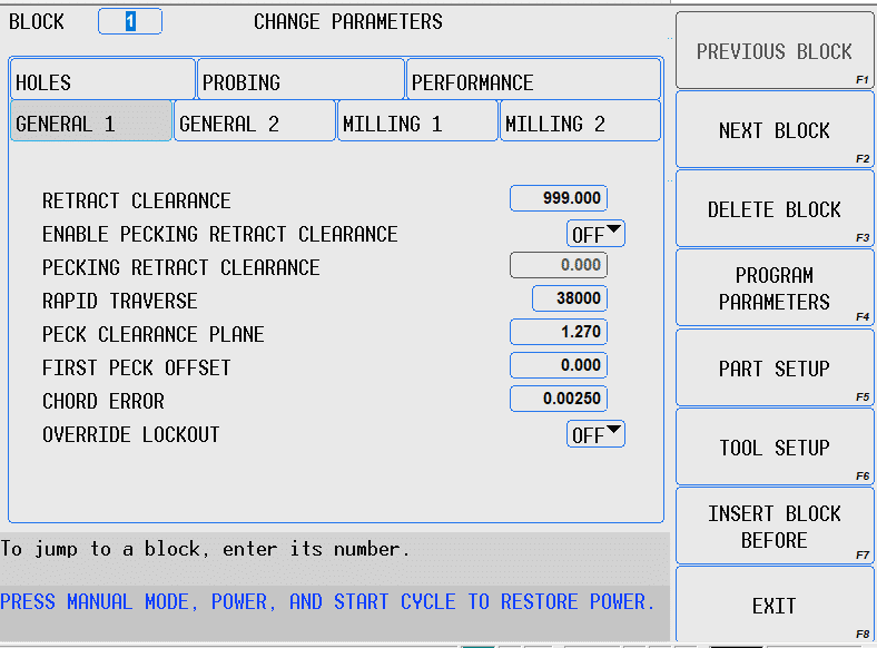

Good news, you don’t have to lose your Part Offset when you forget to save your program.

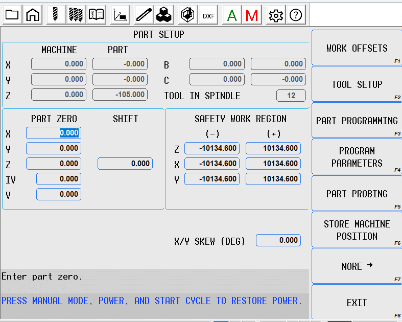

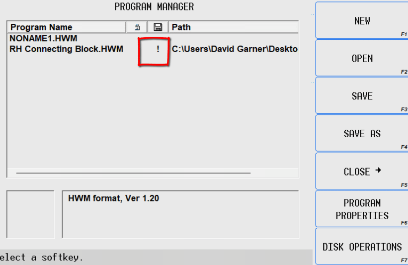

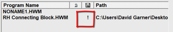

One of them is that your work Part offset is on a separate screen and when you change programs if you forgot to save the one you were working all of hells shit will break lose.
Hurco CNC Training
That little exclamation mark should be six feet tall in my opinion, ignore it at your peril.
