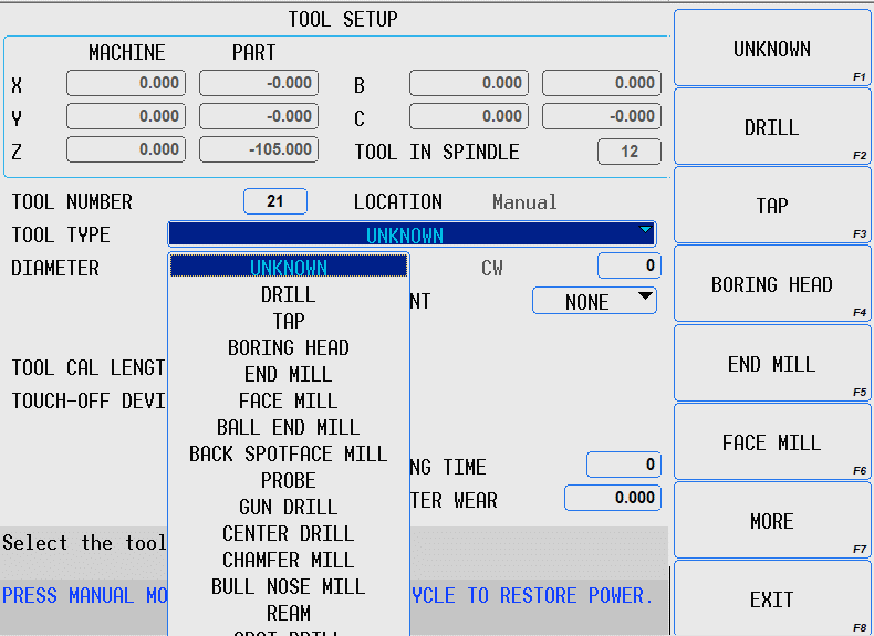

First of all you can call the tool anything you like, well sort of as long as it’s a number.
Anyway I’m confusing myself here, you give it a number from 1 to 999
You then decide if it is AUTO or MANUAL. The control will then decide what to do with it.

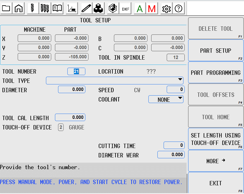

To define a tool go to Tool Setup Screen type in a new number for your new tool.

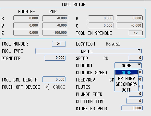

As you go to each dropdown menu the option will appear on the right as well.
Now pick your tool, fill in diameter of the tool. Select which coolant type you want PRIMARY is usually the main nozzle supply and SECONDARY is through spindle.
