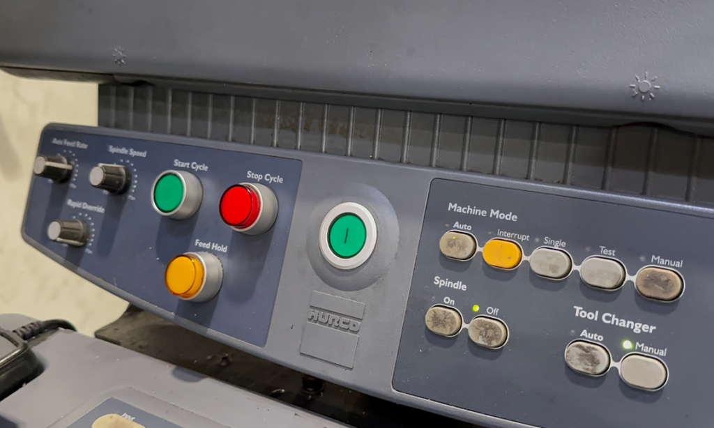

Hurco Tool Changer How To Change and Load Tools
Hurco Tool Changer
The Hurco tool changer is a strange old beast but trust me you will get to love and respect it as time goes on.
Hurco Training
First of all you can call the tool anything you like, well sort of as long as it’s a number.
Anyway I’m confusing myself here, you give it a number from 1 to 999
You then decide if it is AUTO or MANUAL. The control will then decide what to do with it.
