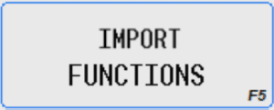

Hurco Import Tools
After selecting a program press IMPORT

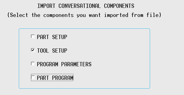

You will then see this screen below. Now simple untick every box except for TOOL SETUP
Hurco Import Tools

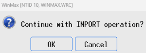

Press BEGIN OPERATION
You will then be asked to continue with operation
Hurco Import Tools
