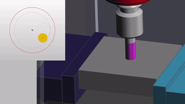

Anyway on this control there are lots of extra cycles like G12 which is full circle milling also found on Haas controls. This cycle can rough and finish a circular pocket. You could just use it to mill a full circle, it uses a tangential approach so there are no entry and exit marks.
Toshiba Tosnuc CNC Training
This circular pocket also uses cutter compensation. So you don’t have to worry your sweet little head about G41 and G42 it’s all included. It’s like one of those holidays in Spain where you can get drunk all day and eat as many burgers as you want, all inclusive.
