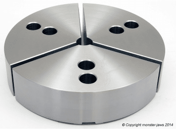

I remember we were trying to turn and bore some motor bodies on a Mori Seiki lathe and we could not get them round. Anyway he told me to weld up some jaws so that they would fully envelop the part.
Basically the part had nowhere to go. It was like a big collet and it worked.
They are nowadays called pie jaws which you can buy from your local tool supplier or from Gregg’s as part of a meal deal
