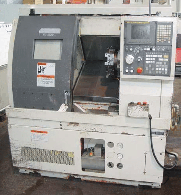

Recently got to work in Skegness which is a bit of an awkward drive for me. Anyway it was well worth the drive to get to work on a Takisawa CNC Lathe. This little beast has a very compact footprint. I recon it was once used with a Robot because it  had a power operated door. It’s a Takisawa Tc 200
You might even be able to buy this one
This is not the actual one but you could buy this and many others machines at:
Thanks for letting me use your picture.

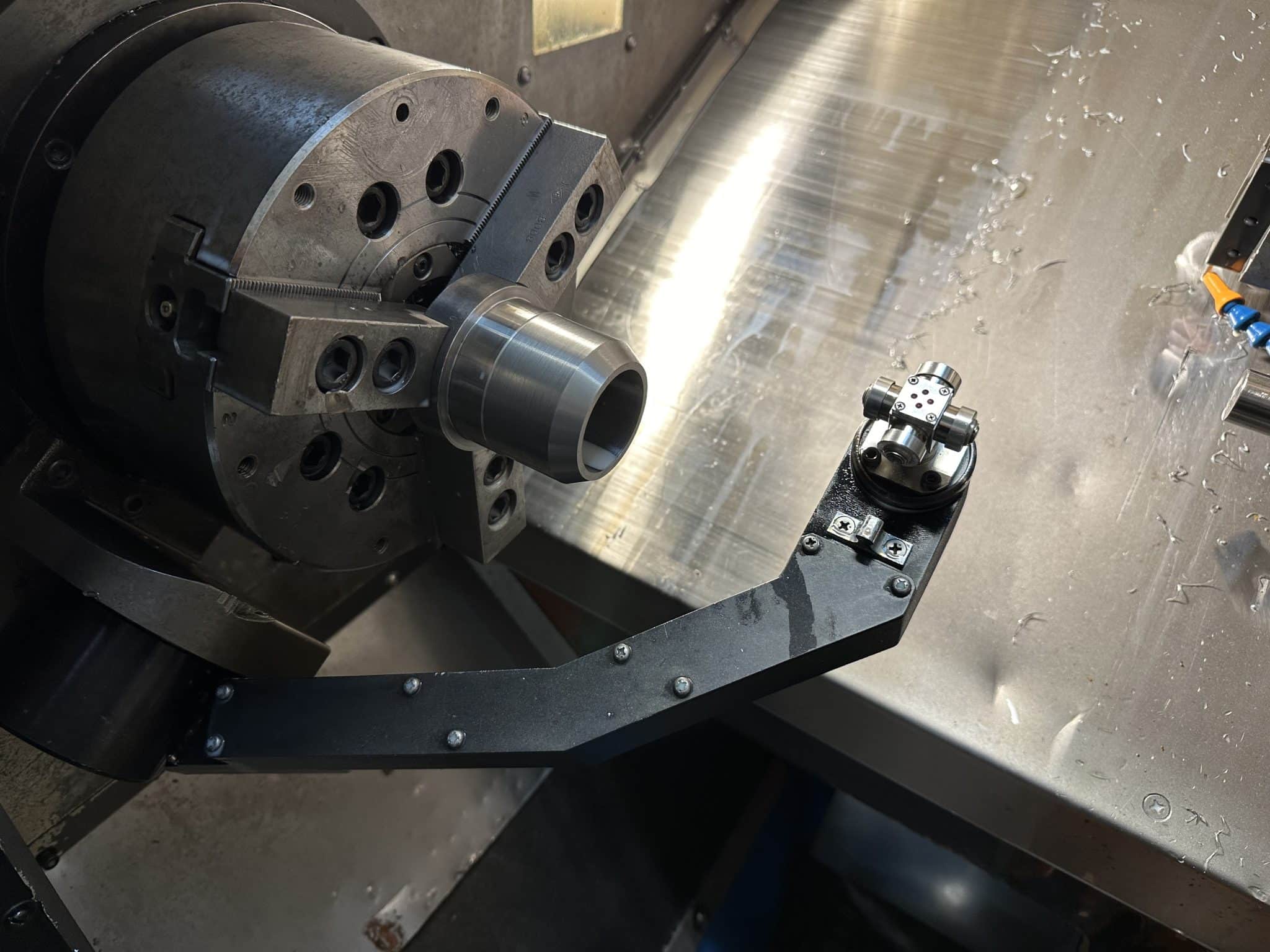

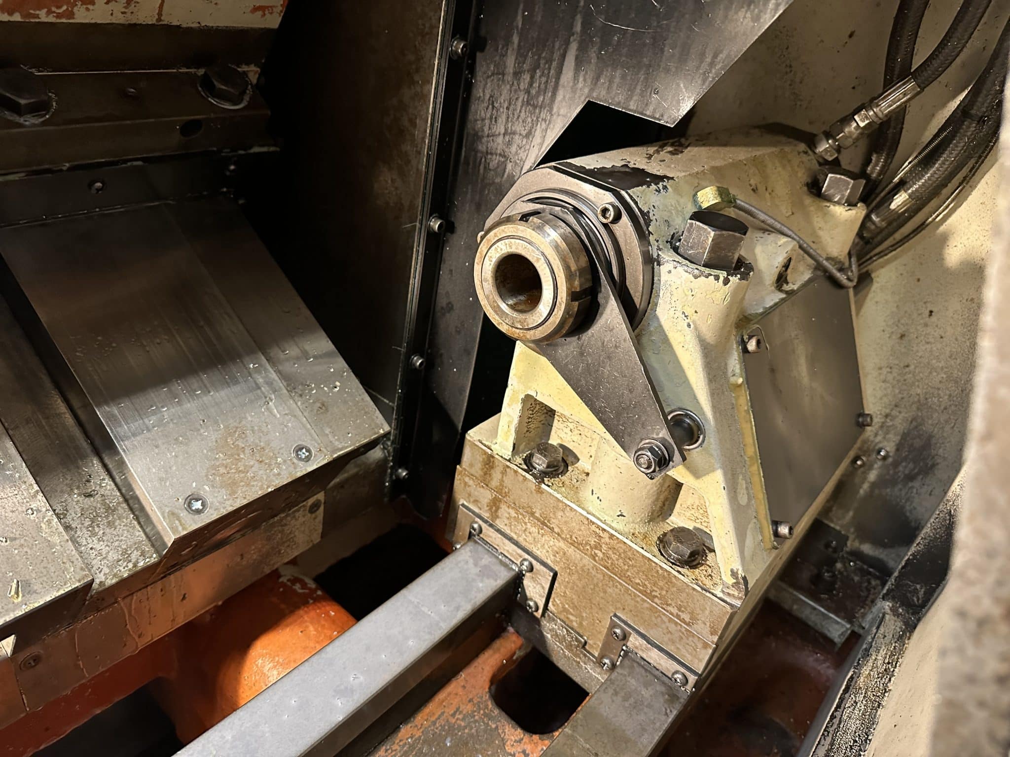

This machine has some strange quirks, but then don’t they all. Setting tools is a bit convoluted but I can see the logic.
To start with the turret must be at zero return when the arm is brought down.
Takisawa
It will then jump to the correct offset and display the geometry screen, very nice. It’s a pain in the arse if you forget as it will still work but it doesn’t record the offset. Having put you through all this rigmarole it still lets you index the turret with the arm down and in any position so be careful.
I shouldn’t moan too much because it does have some common sense built in.
1 The feed-rate is locked in at 30mm per minute when you use the jog button and the rapid is restricted to minimum (phew).
2 Also it zeros out the wear when you measure a tool. Oh and smart arses note not all controls do this.
We did actually rapid the tool into the arm and it stopped, fuckin scary. Still at least I now know what happens when you do it (Thanks Dave). That’s not me by the way, no one ever gets to call me Dave.

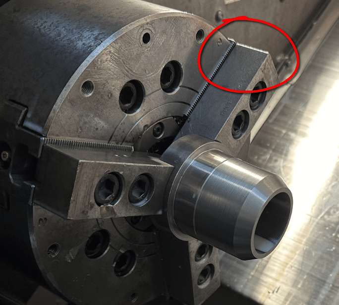

NO OVERHANGING JAWS
Even though everyone does it, your chuck jaws should never protrude past the full diameter of the chuck body. If you don’t believe me read the manual, you know it’s that book you used under one leg of the machine to stop it rocking in G96.
Takisawa
Takisawa Jaw Overhang
Never is it more important than when you have a turret where tool positions are as tight as a duck arse.
So you have been warned. With hard jaws I admit it is almost impossible. I would recommend taking everything out of the turret that you are not using.
Also keep an eye on the tool measurement arm as protruding chuck jaws can clobber that too.

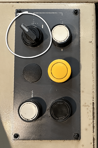

Setting the work-shift is fuckin weird on this machine but I think all Takisawa use the same method. Lets say different not weird and less of the foul language please David.
Firstly make sure the turret is at zero return in X and Z (it won’t work otherwise). This machine loves its zero return position.
Then throw this switch.

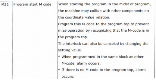

This machine has to have an M22 at the beginning of the program otherwise it won’t run. I put out a post on LinkedIn to see if anyone could give me more info on it but to no avail.
I hate having to say to people “well it’s just got to be there”

Anyway if you know more about it then message me.

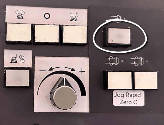

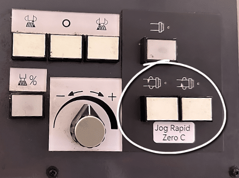

C Axis
The C axis can be engaged by this button from this little panel or M76 in MDI.
These two buttons will jog or rapid the C axis depending on which mode you select (jog or rapid)
You can start your driven tools from here too, how nice.

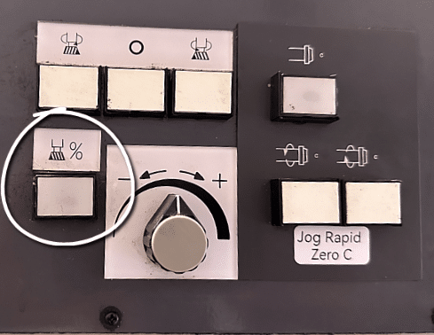

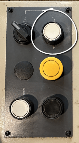

This Takisawa CNC Lathe has a  potentiometer for starting the spindles manually so you don’t program the speed in MDI before you manually start the spindle. The potentiometer still doubles as a spindle percentage override but you actually switch the override on and off with this.
Main spindle works on the same principle. Press this button to turn potentiometer to spindle percentage override.
You need to be careful you don’t start the spindle too fast and potentially shit your pants when it’s way too fast.

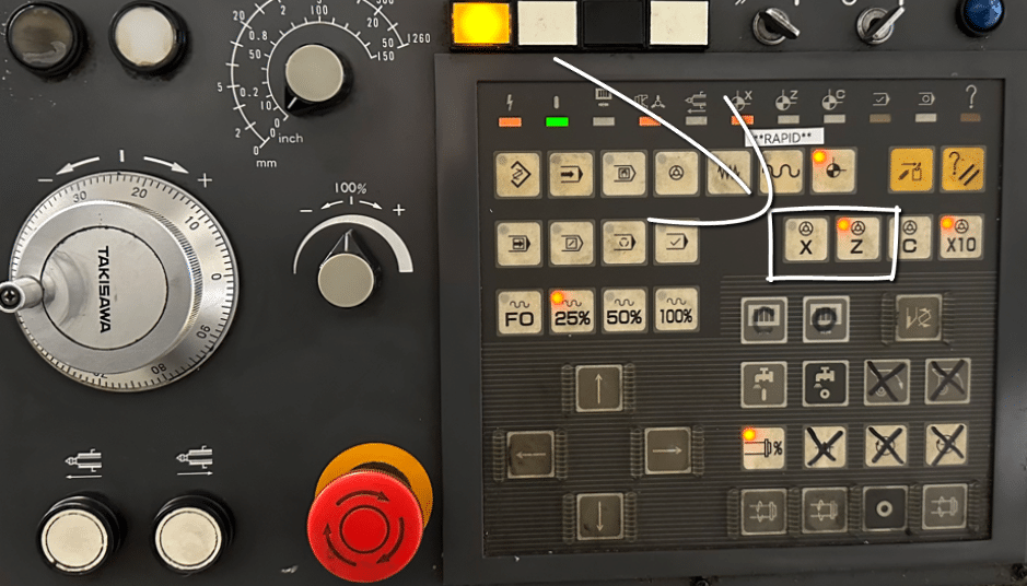

Although sometimes I don’t follow Japanese logic. This CNC Lathe seems very safety conscious. It would have got on great with my mum.
Also they did invent the “Karate Kid” which is a great movie.

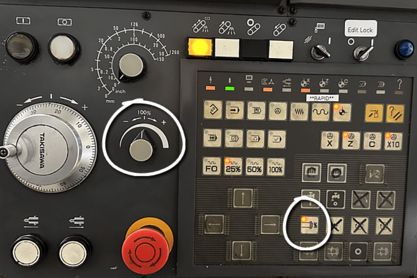

Slow rapid with the door open.
Only index turret with the door closed
Can’t start spindle with the door open.
Hand-wheel holy fuckin shit what is going on there
(0.01 increment is the maximum yes you heard it 0.01)
I mean if you superglued the turret to a fuckin slug it would move faster. It effectively makes the hand-wheel a useless piece of shit. Sorry Mr Takisawa but someone needs to tell you. Even my mother would have got pissed off with the speed of this thing.
CNC Lathe
These guys should try out a Haas, 1mm increment on the hand wheel shit off a stick springs to mind.
Now that’s what I call a goddam hand-wheel it’s the Lamborghini of hand wheels and you need to be over 18 with a clean drivers licence to use it.
Takisawa Training

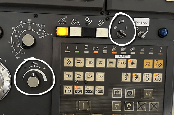

Anyway enough said. Once you turn this baby (that’s the guy in the circle below).
Takisawa
Suddenly the machine takes a massive snort of pure cocaine.
“Health and safety, piss off, let’s get on with this”

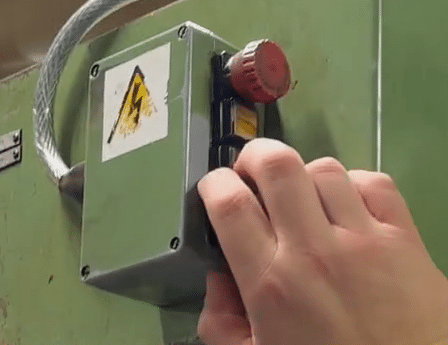

  1. Spindle works with door open
  2. Turret indexes
  3. Jog works
  4. Rapid works at 25%
  5. You can even run a program with the door open!!!
  6. MDI works
Suddenly this Takisawa machine got it’s kit off. The parents are away for the weekend let’s party.
Sadly no improvement on that sad fuckin hand-wheel (still in intensive care).

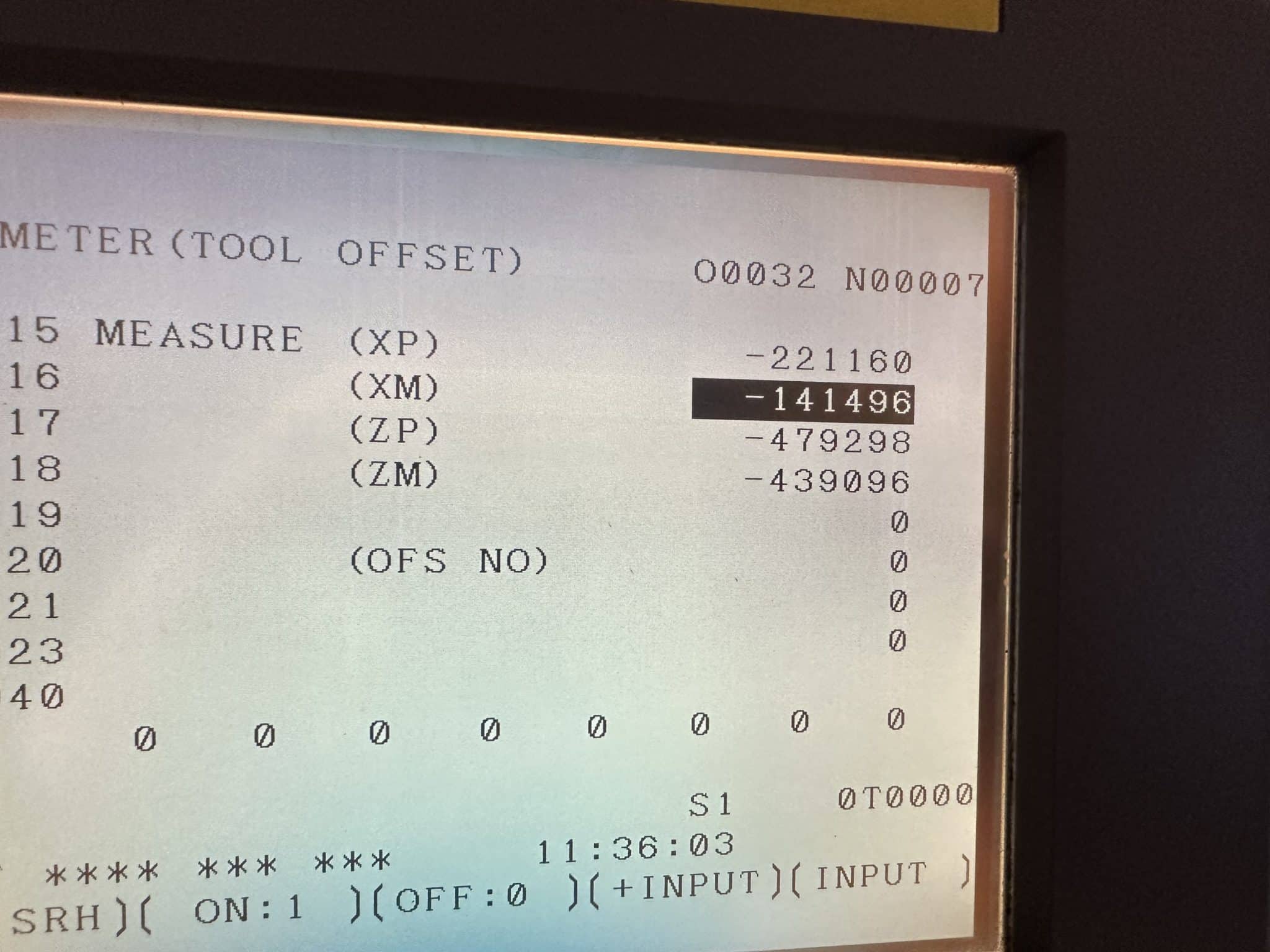

Takisawa Fanuc 21i uses these four parameters
XP is the outer X
XM is the inner X
ZP is the left hand Z
ZM is the right hand Z
Suck It n See
Best thing to do here is adjust the figure you fancy by a large amount say 10mm then check tool and see what it does to the offset. From then on you will know exactly how the adjustment works.
Don’t forget this number is and integer. Ha ha got you there, be honest you had to google that. Never mind thicko.
This means no decimal point.
-141496
Is actually -141.496 so just miss out the decimal point.

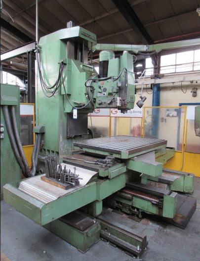

It’s a Boko vertical machine that has a retro Heidenhain 426 CB control.

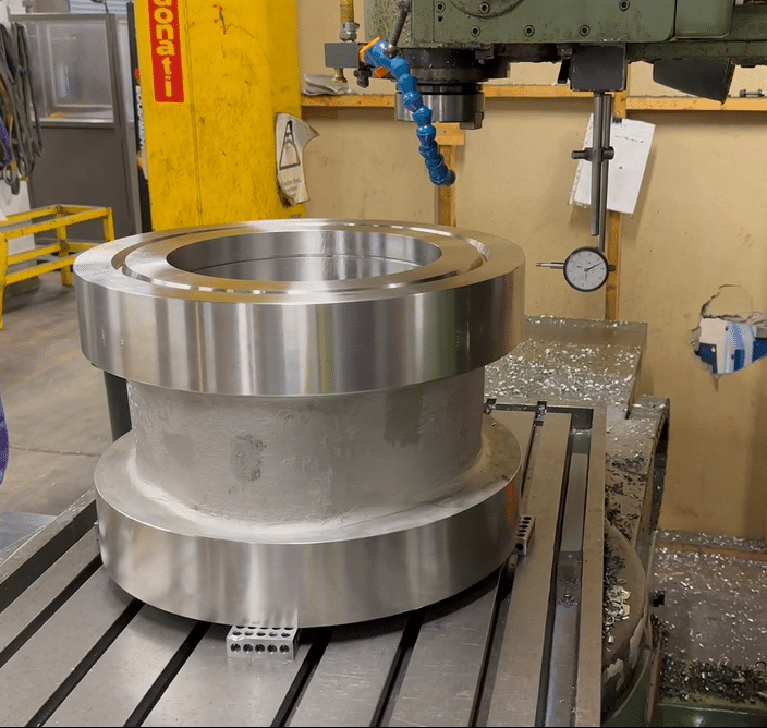

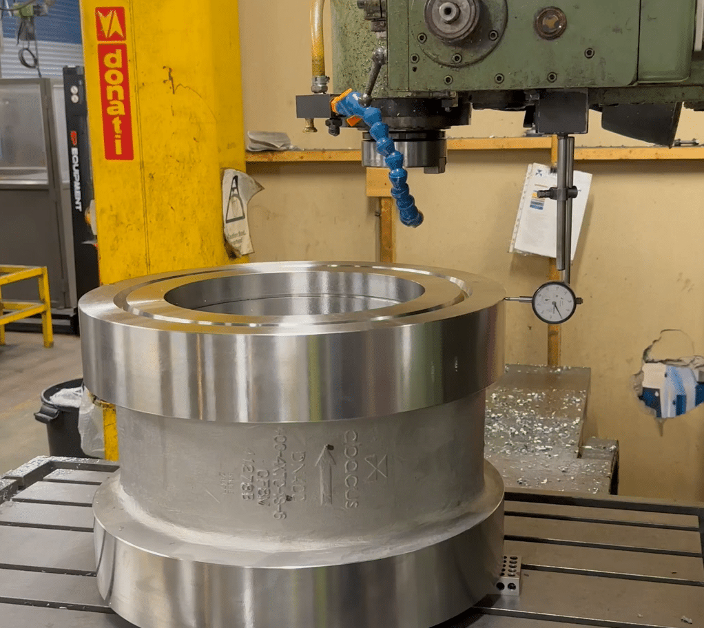

It’s used to make large valve bodies like this. To be honest I can’t remember when I had so much fun and kept my clothes on. Please don’t dwell too much on that thought, this is a septuagenarian speaking.

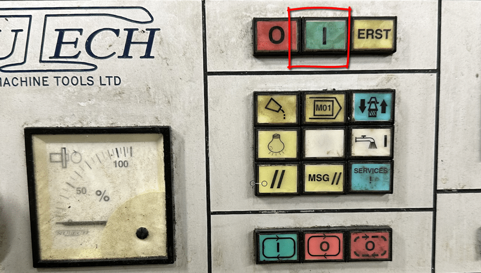

To switch it on is a bit like when they open an ancient tomb in Indiana Jones.
Unless you know the exact combination and are wearing the signet ring of “The Ancient Goddess of Heidenhain Programming” it refuses to fuckin start up.
Onsite Training, Turn on the machine
Clear all emergency stop buttons and press this.

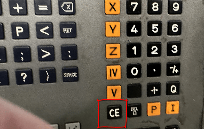

By the way the CE button on Heidenhain seems to clear everything so just press away at that one.
I know it’s dirty but I just want to make it real. Oh and it’s not my job to clean the fuckin machine.

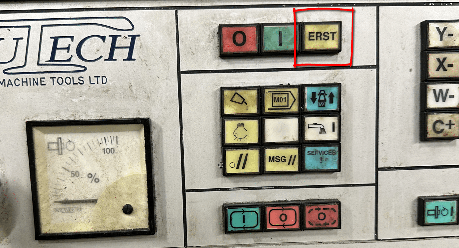

Anyway wait a while till the control comes on and press this
ERST I would imagine stands for emergency reset. Anyway I think not being able to switch on the machine is definitely an emergency. Especially when someone is looking over your shoulder, obviously thinking “does this twat know what he’s doing?”
Everything now springs to life.

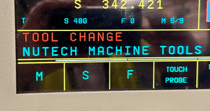

Tool Change
The tool change procedure is a bit convoluted to say the least. The problem is that when you retro fit CNC to a manual machine there are bound to be compromises.
Anyway it’s not a quick process and not for the faint-hearted.
Use MDI to make sure the machine is in a low gear. Now run an M6 and the machine guides you through.
onsite training
Now press the button on the draw bar which releases the tool.
onsite training
Now you need to support the tool and beat the living shit out of it until it drops. You can then load the new tool.
All this button does it to undo the threaded drawbar.
You then press the tool-change button to end the tool-change and it’s all over.
