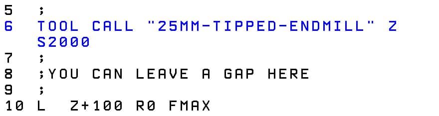

Heidenhain has the ability to jump to sections of program really quickly. One of my favorite features Read this.
Yes and make sure your programs are easy to read. Loads of comments and spaced out. This makes them easier to navigate and edit. Read this.
Siemens controls are also very easy to edit COPY/ PASTE an absolute doddle and its really easy to move stuff around. (Siemens 840D Sinumerik)
On your Heidenhain control use this button maybe just to leave gaps and add the odd comment.the best CNC control
Use the colon (;)  to add a comment.
