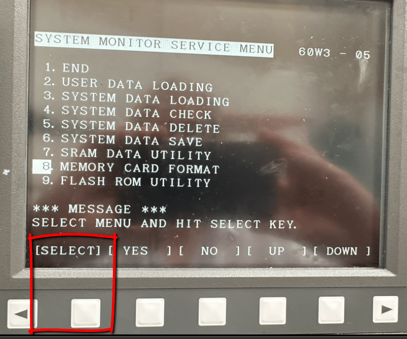

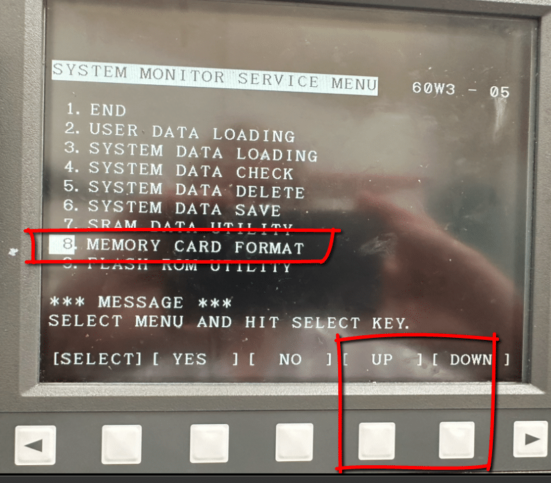

You can now cursor down to.
8. Memory Card Format
Now press [SELECT]
The instructions are on the screen but for some reason, and I include myself in this, most people are too dumb to read them.

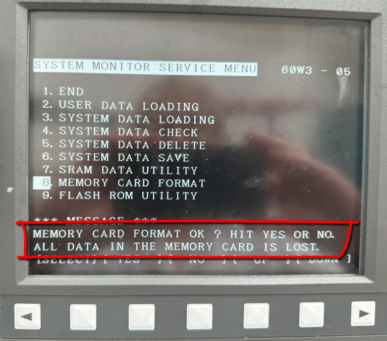

Now just say yes. (Don’t say it press the button)
Format a Data Card on a Fanuc Control
Actually don’t just say yes. I mean sit back take stock of your life think of the decision you are about to make. If there is anything on the data card you want to keep do not proceed. Remove the card immediately, run away from the machine and place the memory card in a bucket of cold water.
The card will be completely empty after formatting. It’s a bit like telling the wife you’ve been shagging the next door neighbour, there is definitely no turning back.

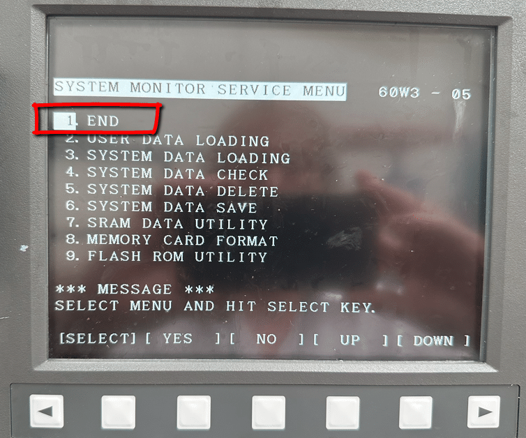

Anyway, after doing this you need to escape. So use the up down arrows to get you back to doing some work instead of pissing about with data cards.
  1. END

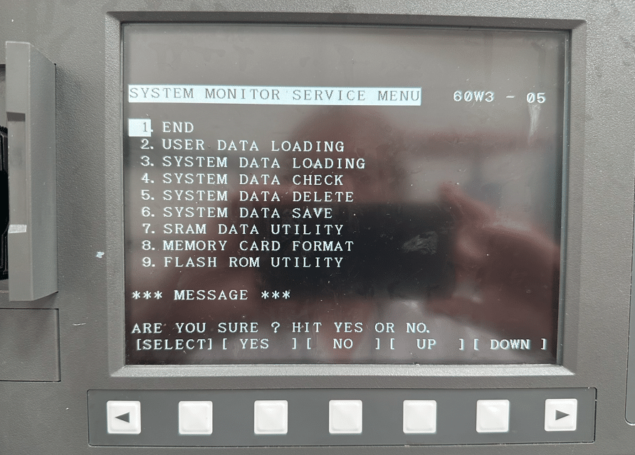

Anyway if you are “really really sure”, and there is not a button for that, press YES.
And that’s it. Your machine will carry on and switch itself on as usual.
