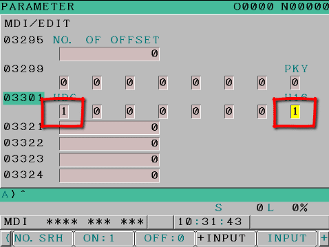

Unlock Programs Fanuc Parameter, first of all you’ll need to go to the setting screen and change the parameter write box to a 1.

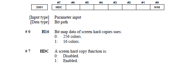

If you want to make screen shots on your Fanuc control this parameter may need altering.
Just press and hold the shift key to make a picture of the screen on your data card or usb.
Should look like this to make it work.
