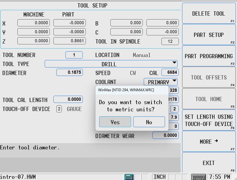

Above I am creating a tool and it’s a 3/16 inch endmill. First of all I’m going to change to inches. I click that little button MM down the bottom there.
Yes MM that’s little beast.
Hurco Converting MM to Inches, you will now get a warning
Imagine it’s the wife and just ignore it, well say YES, you know like you always do.
Your display will now turn to inches by complete magic. Your ok this is not a F****, the control is not about to simultaneously destruct.

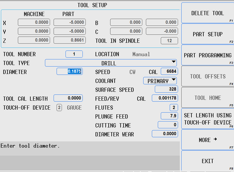

Everything just went to inches. So exciting, I mean really it’s no big deal but if you are used to other controls then I’m afraid it fuckin is a big deal.
Now just type in 3/16 and press ENTER
Guess what it came up with 0.1875 wow wow wow.

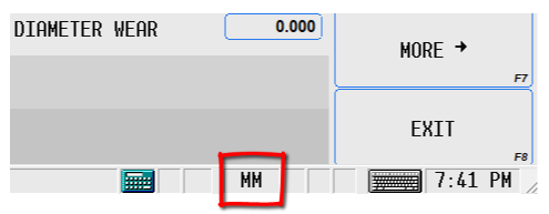

Just one other thing, Press the INCH button, and it goes back to MM.
And it’s back to MM

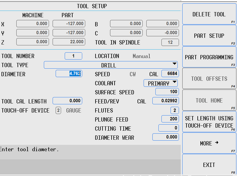

Soooo 3/16 of an inch is 4.762 mm
Hurco Converting MM to Inches, no brain power used.
