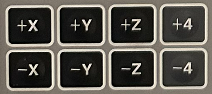

Incremental jog is cool
This machine has incremental jog. I bloody love incremental jog. So useful when setting up.
I never actually use it but it’s just nice to think I can if I want to. Bit like my running machine.
That’s me the surgery deffinately worked.
Adjust from this screen
Brother CNC machine operation
And use these arrows to get different increments.
Brother CNC training
Now press the axis button to move the axis in steps.
There you go I knew you’d like it.

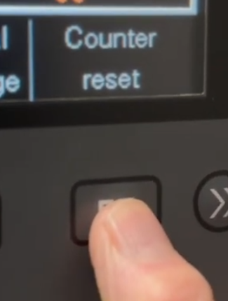

When you edit n stuff you have to tell it you want to leave the screen and keep the edit “of course I fuckin do”
In all fairness to Mr Brother I suppose if you changes your mind you might wanna revert back. Mmmm the jury’s out.
Sorry but this is annoying. I mean you might love it. I wont argue with you, your doctor told me not to.

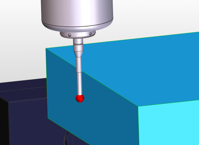

This one has Blum probing, that is table probe and spindle probe. Nice to have but I wish it had a user interface to make it really simple instead of keep altering programs n shit. Another minor grumble. Maybe it was just the original buyer who was too mean to pay a bit more for it. Who knows.

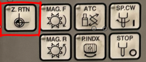

To turn on the spindle manually press SP CW
Brother CNC machine training
Spindle Start
It starts up and goes green

Brother Manual Mode Zero Return
This button will return all axis to zero, it always does Z first, so no panic there.
Zero Return Button

Rapid Traverse
The rapid works the same way.
Use your X Y Z keys to Step, Rapid or Jog
Axis Buttons

The machine has a RELATIVE position display that can be zeroed. This is purely for manual use and the machine ignores it.
Press counter reset soft key. It’s yours, do what you want with it. It’s no one else business.
You can now move to each axis and zero it or press “Set all axis to zero”  (F1 soft key)
Reset X Y Z
